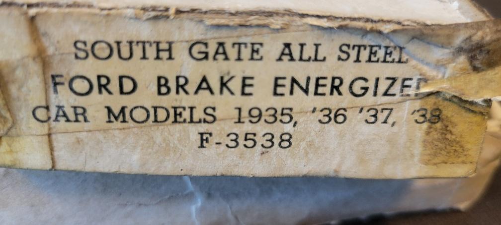

I have brake floater kits I beleive ,send me an email kiwi37@att.net ,they say 35-38 on box

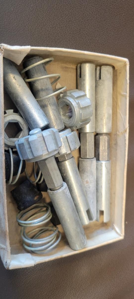

these are what I have.
