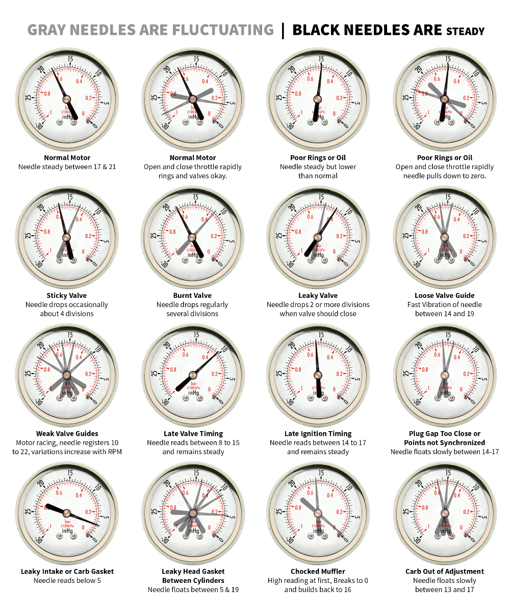

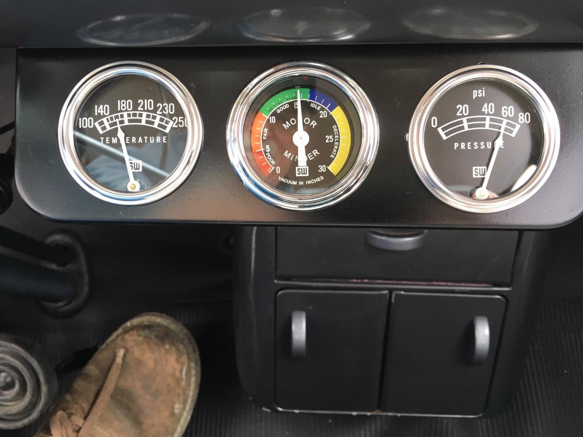

I have found the best tool for troubleshooting a poorly performing engine is a vacuum gauge. (Available at most auto parts store.). Connect an appropriate size and length of hose to a port on the intake manifold (wiper vacuum connection) so you can read the gauge from inside car. Start the engine, and while it is warming up, compare the gauge reading the the attached chart. If all looks normal, go for a short drive to see what readings you get. These tests will save a lot of guess work, and frustration. The gauge panel pics are from my stock (except for gauges) '46 Super Deluxe Coupe.

I agree The vacuum gauge is without doubt the most useful trouble shooting and tuning tool there is -Karl
