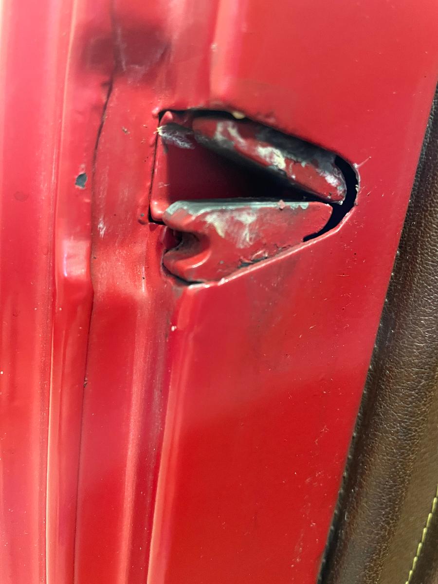

I ordered some new dovetails from Macs last week and I don’t know, maybe they sent me the wrong ones because they sure won’t work. So, I’m back looking for the correct ones. This is what the old ones look like. Also, how do you remove the top one. I lost the bottom one on the drivers side but the top one is still there. I thought that they were both just held on by a spring. ??????

Push in the block with a flat blade screwdriver and then up (for the bottom block). Pull it out and do the same for the top except push in and down.
