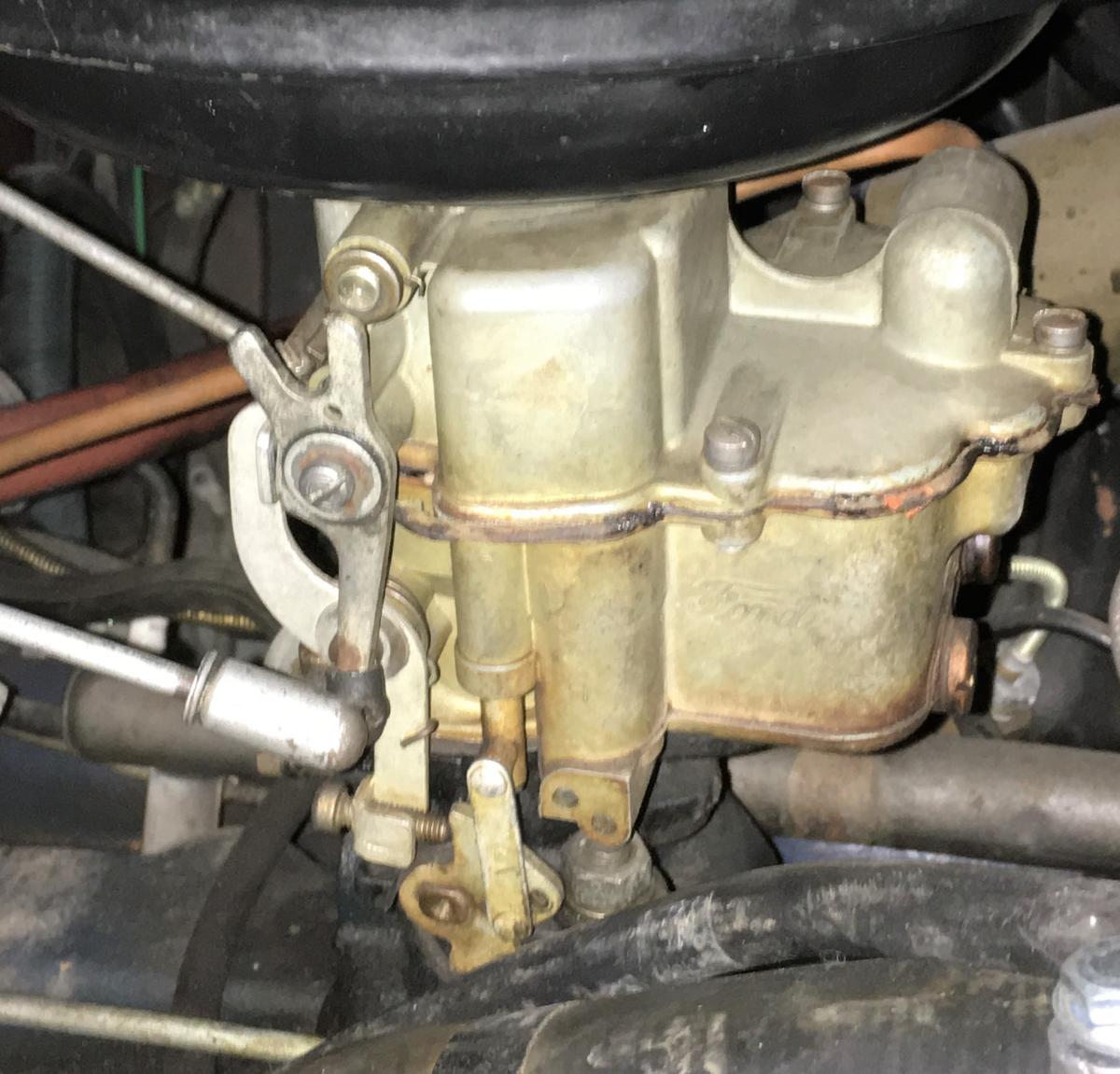

51woodie
03-16-2023 @ 1:56 PM
If your carb similar to the attached picture, it is like carcrazy says, hold the rod and pull on the spring loaded end to release the connection. I'm not sure which vehicle you are working on, but there is a rubber "cap" where the rods connect to the carb levers. Look close at the picture and you will see a bit of the rubber cap sticking out on the choke lever. The P/N is 91A-9714-A in the Carpenter catalogue.

MG. When I bought my ‘46 Super Deluxe Coupe, the carb was over fuelling at idle. When I took the carb off, there was one of those rubbers on the choke connection, but just bits of rubber in the throttle connector. I found them listed in Carpenter’s catalogue, so I replaced them. Not to leave anyone in suspense, I rebuilt the carb and it was better, but eventually sent it and the fuel pump to Charlie NY, and now the engine runs like a new one.
Why the rubbers? Are they insulators/isolators, or just take up any free play in the connection.
