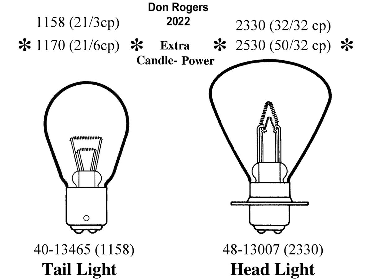

Don Rogers
03-24-2023 @ 9:17 PM
Posts: 512
This may help. It shows the 1158 tail lamp with alignment pins perpendicular to filament contacts. It also shows an 1170 which has a higher candlepower running light filament.
