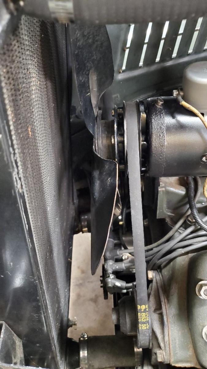

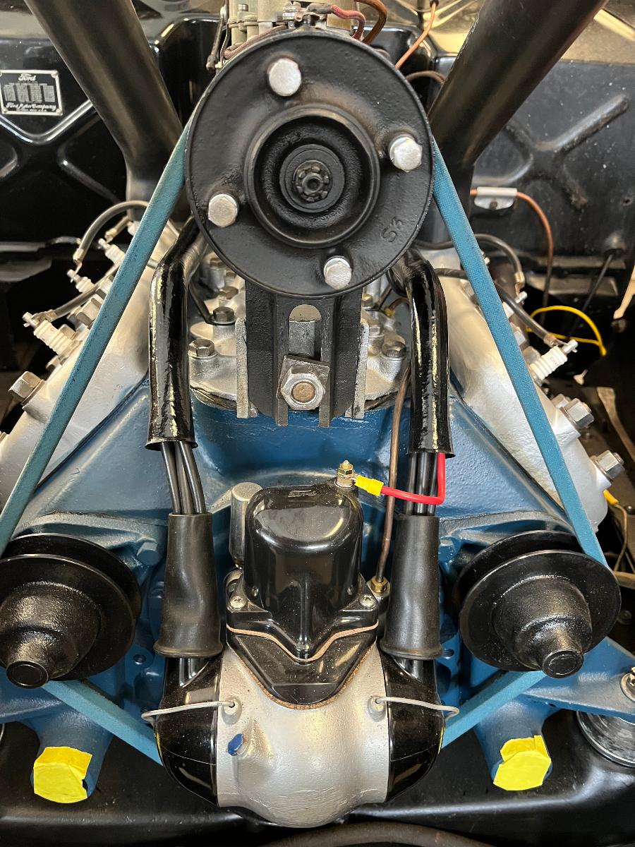

Have installed 1937 21 stud flathead V8 in my 1935 3 window coupe. (previously had 1935 21 stud flathead V8).
Fans and generators from both engines are the same.

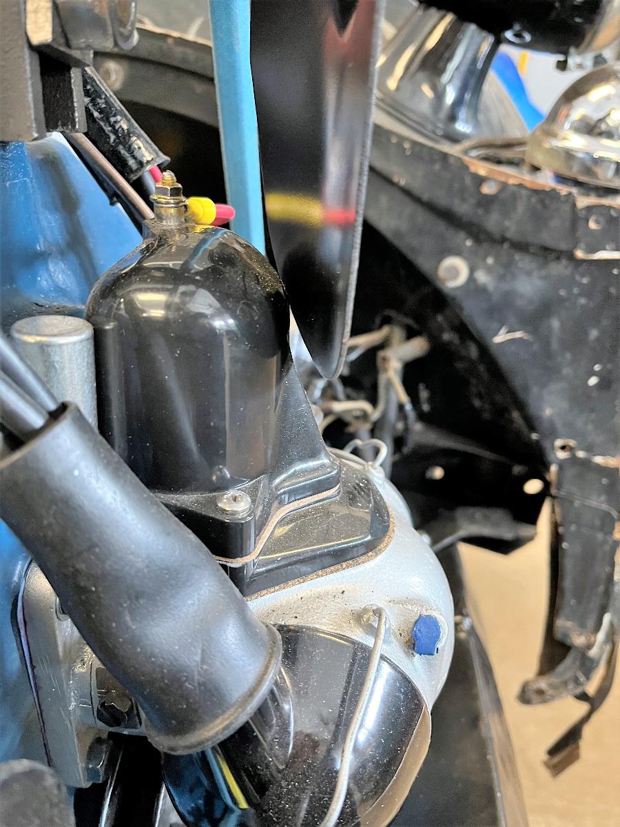

When I installed the fan I noticed the back of each fan blade will hit the coil if it were to rotate.
any ideas as to what I may be doing wrong or what corrective action is required.. different fan?? .. add spacers to the fan to generator mount??..

it looks like you need to replace your 37 intake with a 35/36 intake. This should raise your generator and fan. Also a 35/36 coil would have a lower profile than the one you are using.

Thanks to all for the solutions.. I had tried shimming the fan forward a bit to no real effective fix.( issue now becomes radiator clearance) The intake that is installed on the 37 engine is from the 37.. all components are from that engine and assumed the clearances would not have changed. The fan belt that is installed is 54" x 5/8... I do have sufficient length on the generator mount to raise it and will install a 55" belt and it should remedy.. this will raise the generator about 1/2" and won't impact it's proximity to the upper rad hoses..

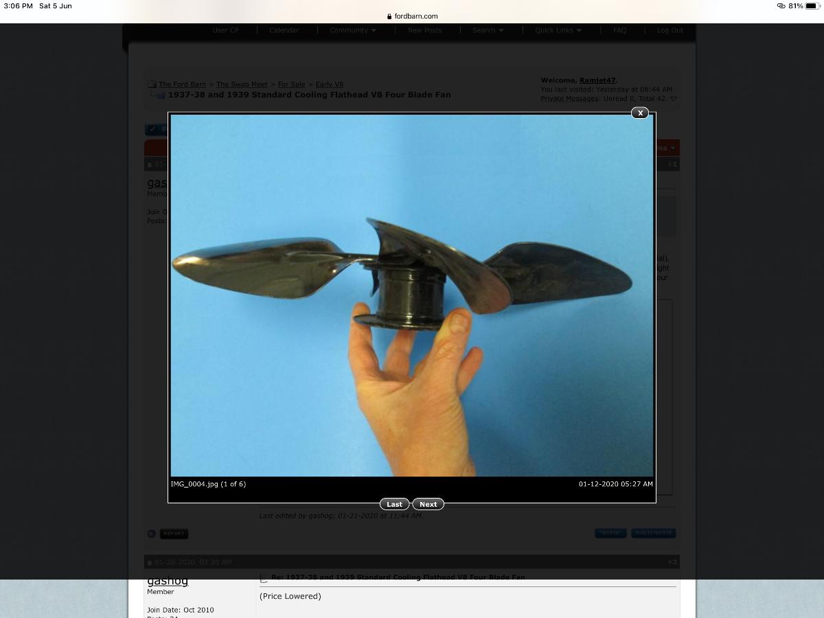

Researched information of fans... and 1937 fan has a "neck" of 2" from mounting plate to fan, whereas the 1935 "neck" is 1"..
Both fans have same radius (blade length).
The extra offset forward will definitely clear the distributor & coil and still would appear to leave enough clearance with the rad.

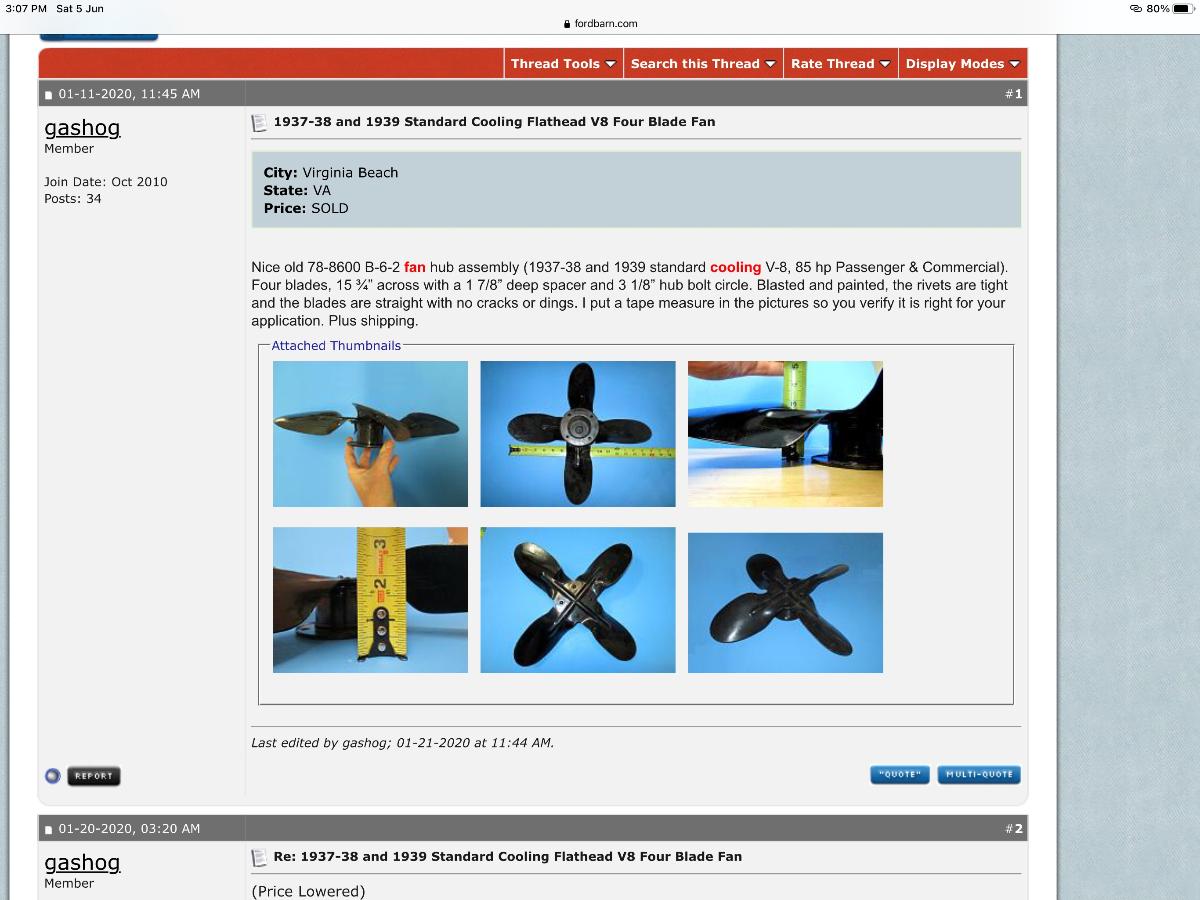

Ramjet47
03-03-2023 @ 1:07 AM
Posts: 2
Joined: Mar 2015
This attached advertisement shows a 37-38 & 39 std fan. I had the same problem, purchased what was sold to me as a 37 fan which turned out to be a 34 - 36 fan, too short in the hub. My 37 - 38 & 39 std fan clears the radiator and original 37 coil in my 37 coup’e. Best regards, Roger.
