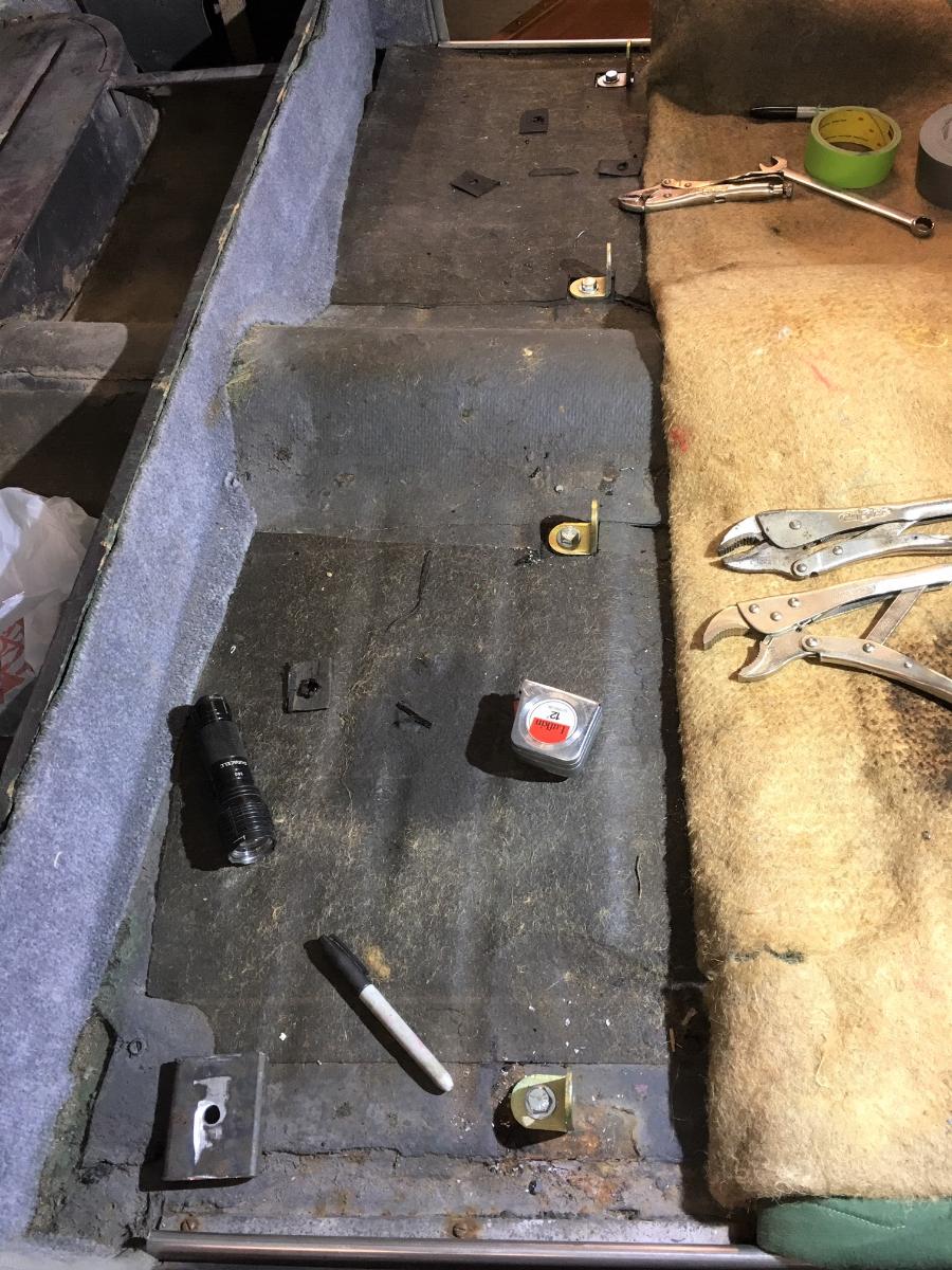

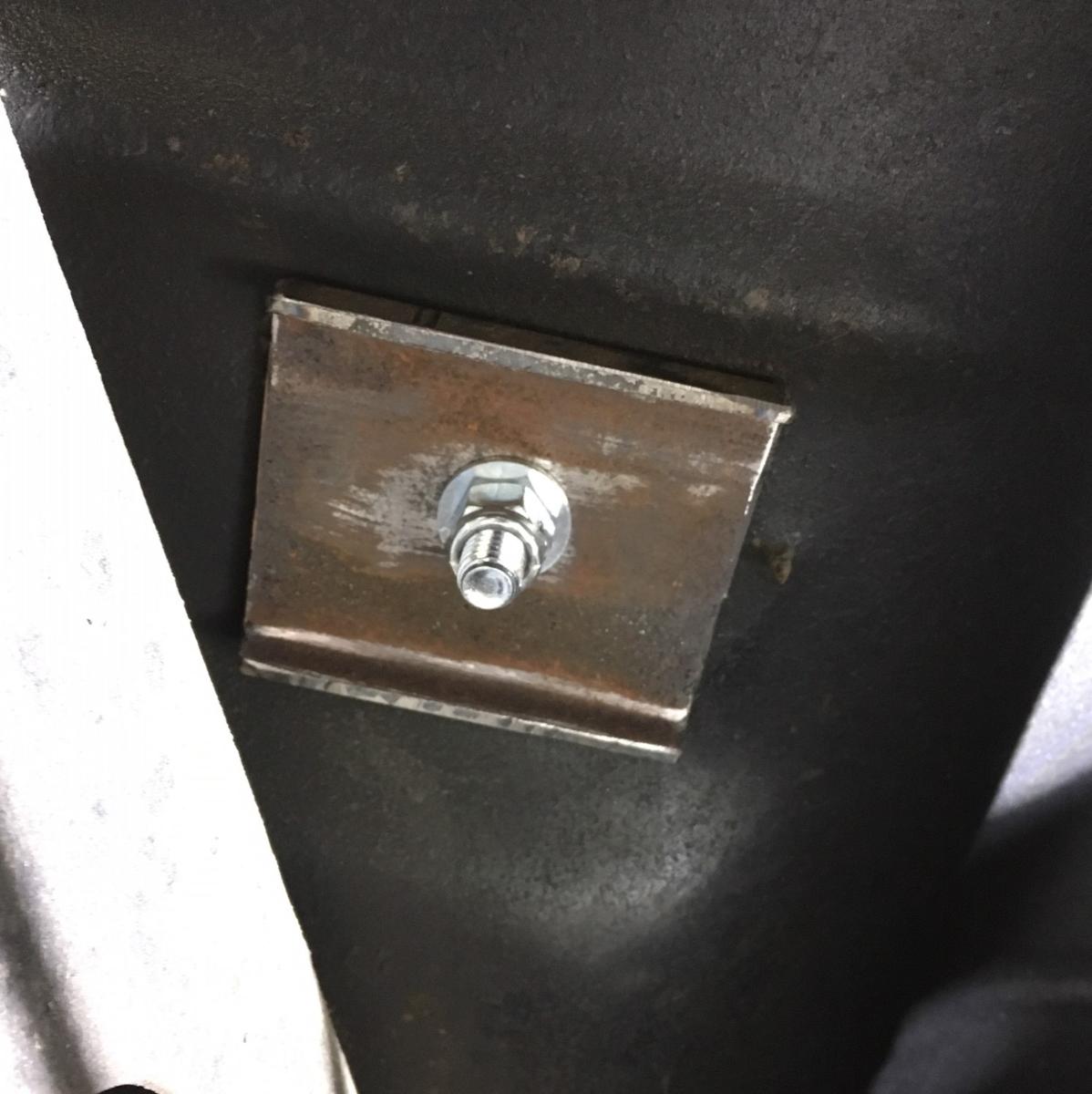

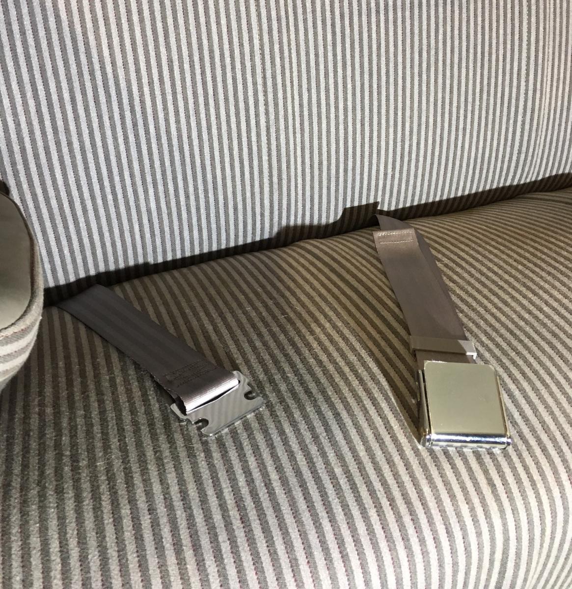

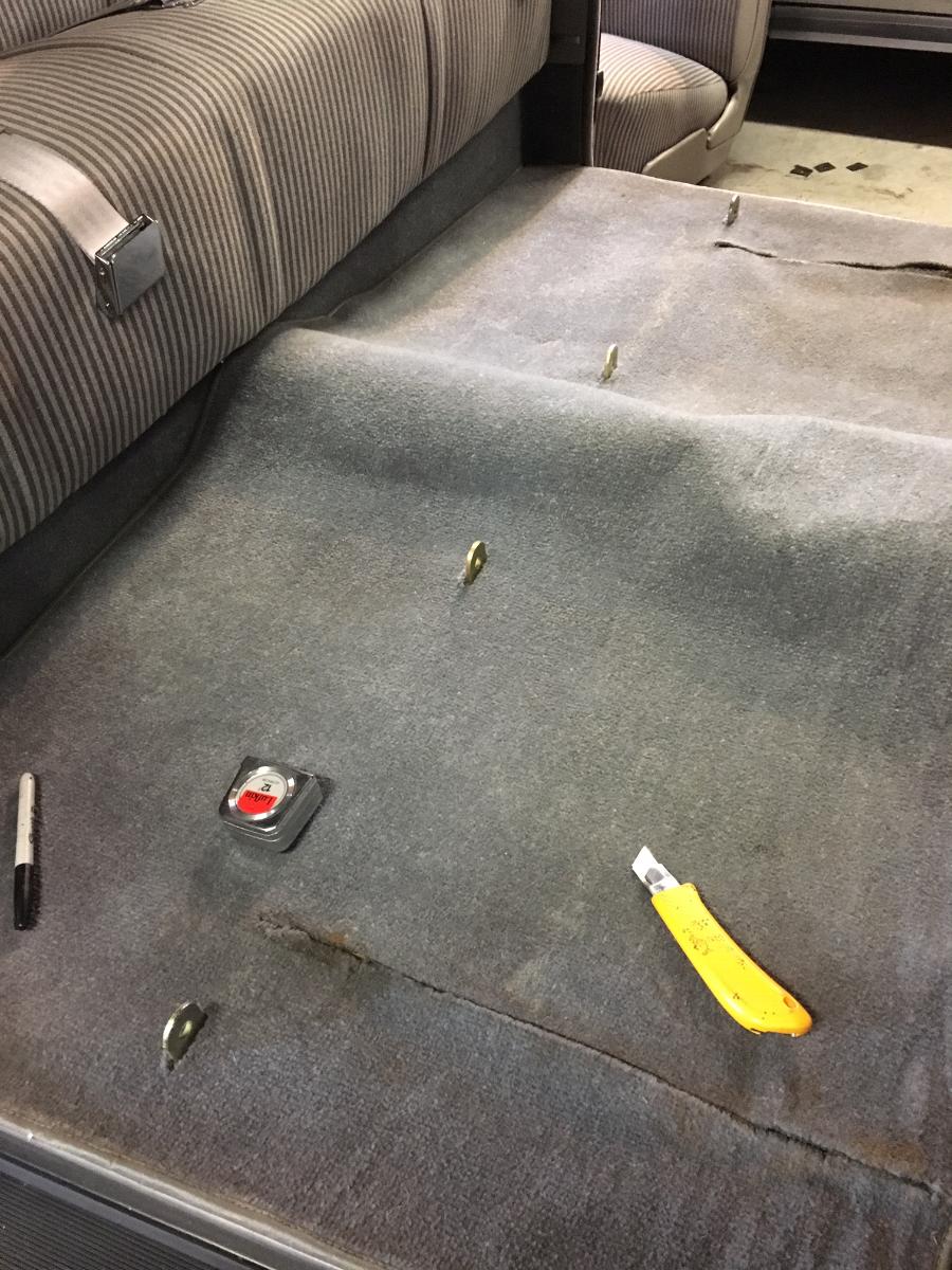

I also got my belts from Seat belts Plus for my '46 Super Deluxe. I only installed lap belts, as I didn't want to disturb the interior to install anchor points on the B pillar. Noted in previous posts: Bolt to the floor pan with reinforcing plates/washers. Do NOT bolt through the frame. https://www.seatbeltsplus.com/ https://www.seatbeltsplus.com/category/2-Point-Lap-Seatbelts.html Scroll to the bottom for install info
