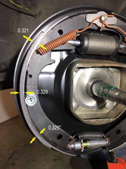

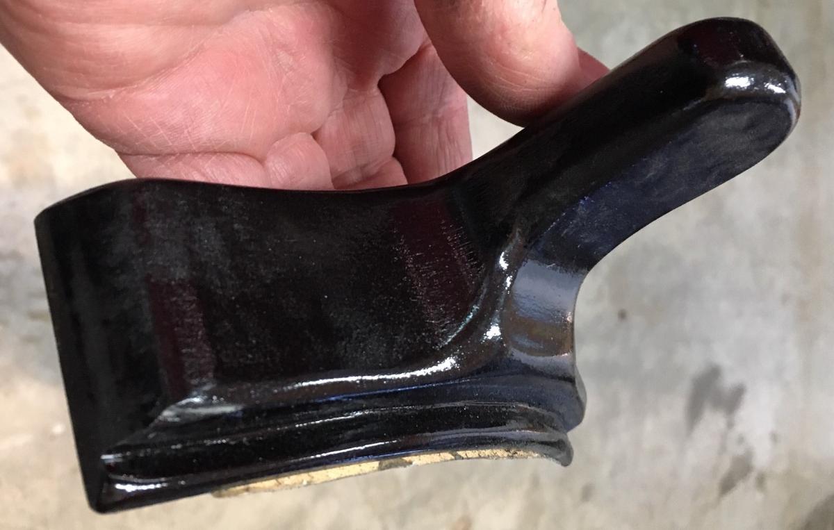

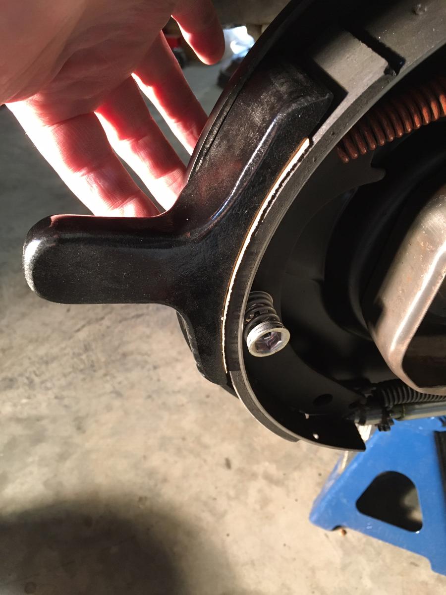

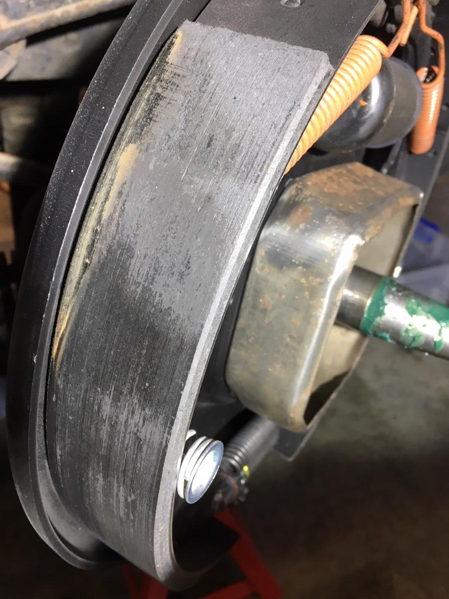

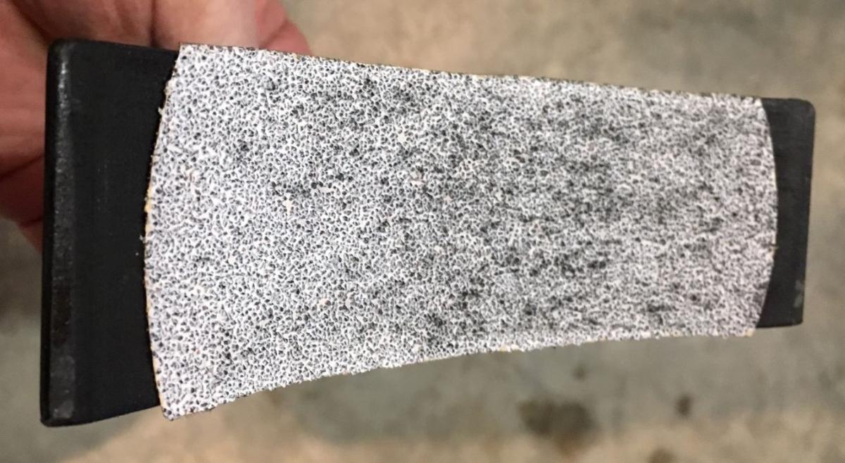

I installed Bendix brake kits as well on my '46 Super Deluxe, and had a similar problem. After driving a few hundred miles, I pulled the drums to check the shoe/drum contact. I found that the shoes were not making good contact with the drums, because the radius of the shoe lining did not match the drum diameter. I measured my drums and they were all stock diameter, +/- a few thou. There are no shops in the area to arc shoes, so I made a tool out of wood, stuck on some sandpaper, and sanded off the high spots. Drove the car another few hundred miles and repeated. I can now make the tires chirp on a hard stop and they don't cause the car to pull off straight. Going to a 3/4" piston master, will give you more force at the wheel cylinder, but more travel at the brake pedal. Check all the items that carcrazy listed, check the shoe contact and correct if needed, then you should be good.
