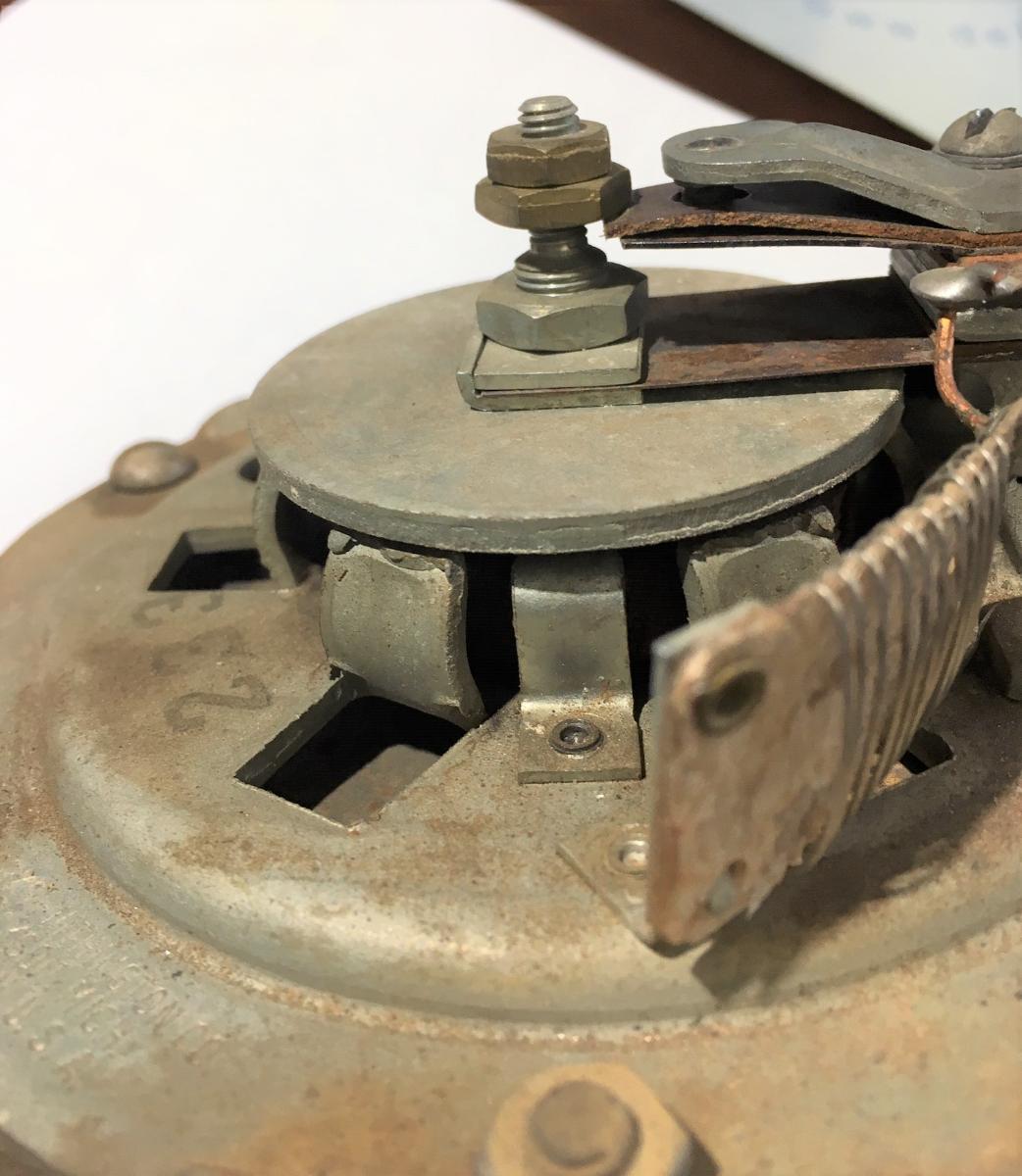

The horns on my car are very weak. I heard there was an adjustment. Can someone explain the process please. Thanks

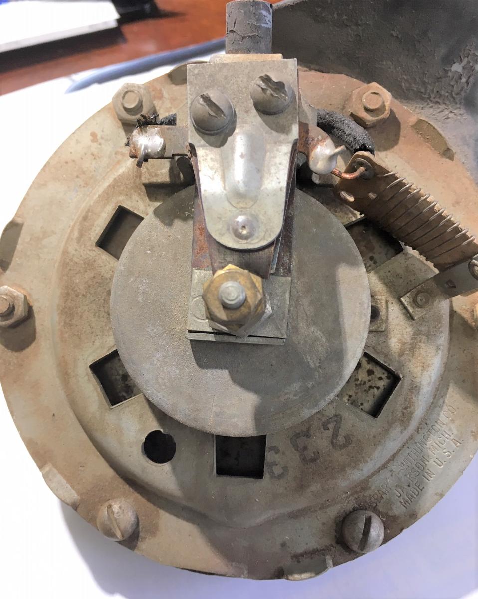

I don't know if the horns on a '46 are similar to the '38 horns or not, but here are pics of the '46 horns with the cover off. The nut and adjusting screw are just above the contact points.
