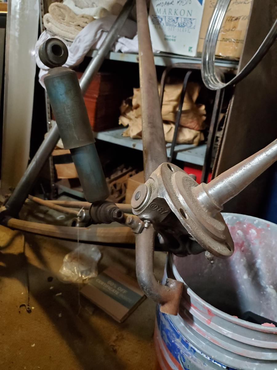

I have had excellent results using a good HD heat-gun on bolts/nuts that don't want to come loose. Use a liberal amount of PT Blaster on the fastener, let it sit for awhile then turn the heat onto it..
If the lower mounting pin is attached to the stock shock axle mount, the hole is tapered like a tie rod . As it has been already mentioned, a pickle fork can help to break the mounting bolt loose.
Don't beat on the threaded end with out a nut on it to protect the threads..
The attached pix is of a '36 front shock conversion, which is typical of all EFV8's.
Bill

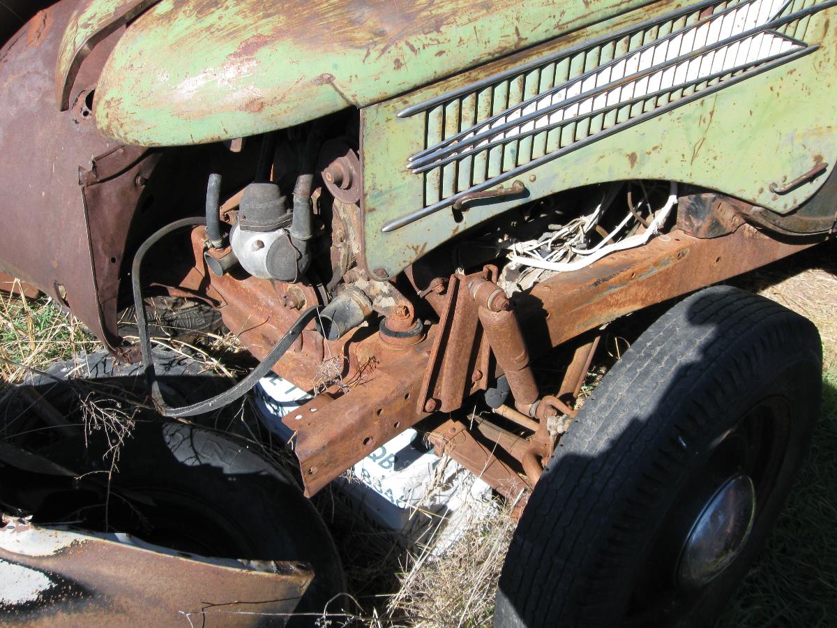

Attached is a pix of the front axle under my '36..
The axle is a 2" dropped '41 with '41 spindles/king pins, wish bone is a '36 with '41 spring. Axle to wish bone mounting bolt is a 41 with tube shocks shown in the pix.
Bill
36 5 win delx cpe

Does anyone know where I can purchase two tubular shock upper mounting brackets like the one shown in the previous pictures? I need them for my current project. Thank you for any information you can provide.
12-10-2022 @ 7:16 AM
Posts: 4356
I have a pair of those sitting in my swap meet box. Send me a PM
