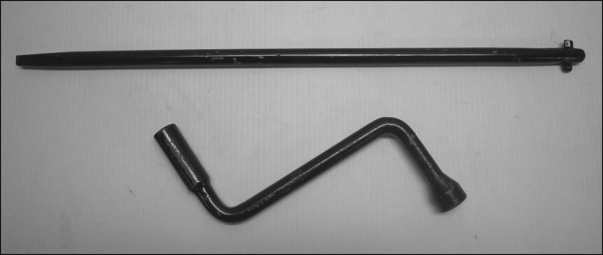

I posted a request in the parts wanted section for a hand crank for my 46 Super Deluxe. Does anyone have one that could send me a picture of it? I saw a picture of one a few years ago but didn't save it.
The restoration book does not have any mention of it. I heard that there was a crank issued with the car and that it was a folding one. I checked my crank and there is a place to put a crank handle. Any help is appreciated. All the ones on ebay seem to be for Ford tractors.

the starting crank comes in 2 parts. the one that goes though the grill varies by year of car or truck by its length
they go together like a socket wrench, square drive,

My next email was going to be to Lin Stacy, I bought a jack from him awhile back. Your description at the end of your post answered several of my questions. Thanks for your help.

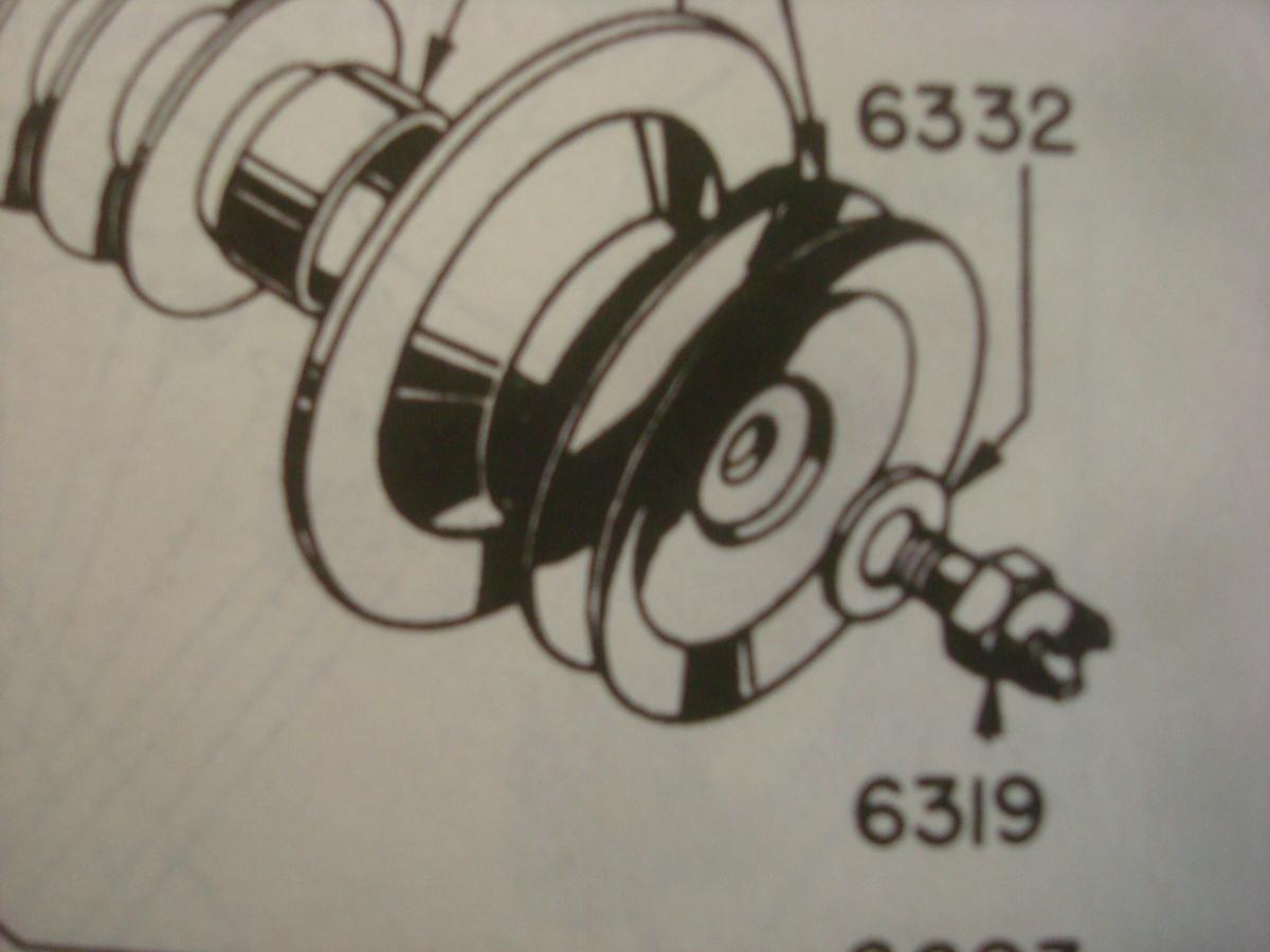

Are there holes in your radiator and grille to accept a hand crank? If there are and you want to use the hand crank to turn the engine over, you can get a deep well socket wrench to fit on the crank pulley ratchet bolt. You could then insert an extension shaft through the holes in the grille and radiator to turn the engine.

Carcrazy, the issue with your method is should the engine start, well, expect at minimum a broken finger.
11-01-2022 @ 6:02 AM
using a socket [ if you can find one that fits over the ratchet nut ] is maybe ok for turning the engine over but NOT for STARTING,
The crankshaft nut is a ratchet nut , this means if you use for starting, once the engine starts it disengages
the starting hand crank .
and be sure NEVER WRAP your thumb around the starting crank, because of kick back
maybe a FORD CATALOG with photos would help, they are free, C&G and others
hope this helps 37Ragtopman
I enclosed a PHOTO of the ratchet nut 6319 this may help you can see it only works one way to the right, direction of engine

Should have mentioned, turn ignition off before turning engine over with a wrench. Make it much easier to turn by also removing all of the spark plugs.
