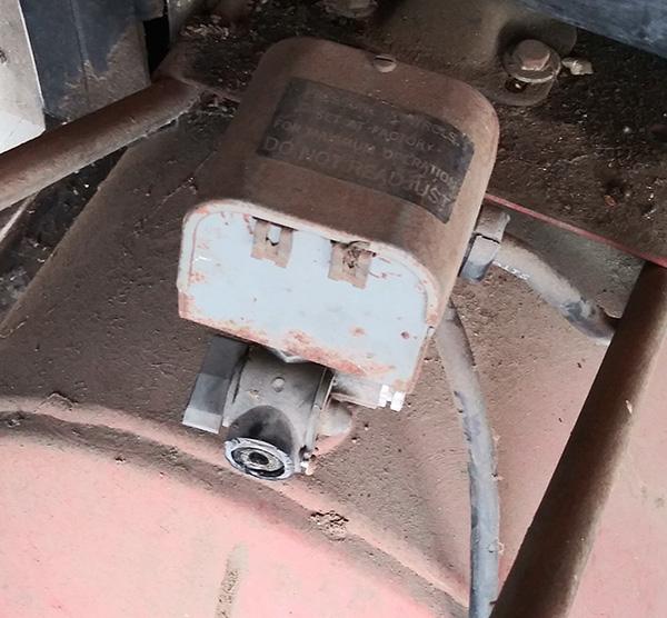

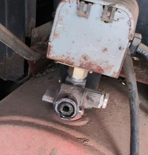

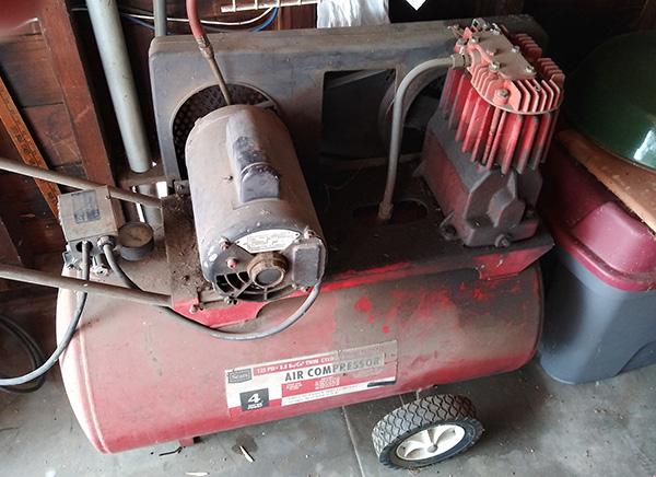

Seeking air compressor help. I have a 40+ year old Sears air compressor model #04217-781484. The last piece of the air outlet broke. It is a plastic piece that reduces the air outlet from (½” ? to ¼”) to connect the air hose fittings. I don’t think it is a simple reducer but has something to do to stop air when changing hoses. Anyone know what this piece is and what it does and how to replace it?

Jerry, prior to placing any money into this unit, PLEASE check the integrity of the tank. Seriously, take a hammer and hit the underside in a number of spots.
Even though these old compressors run well, often the tanks are very thin due to moisture within.
I'd witnessed the aftermath of a 200-gallon compressor tank blowing. It was not pretty.

compressor is actually made by speed air and parts are available thru grainger-might give it a try. also you may be able to remove what appears to be a threaded in fitting with an easy out and replace with a metal bushing and a quick disconnect

I would have very serious doubts about the air tank. They rust from the inside out due to condensed water from humid air. When they fracture the air inside can kill or seriously injure. It appears to be time for a new compressor.

It looks to me like the plastic adaptor is scr*w*d into a cut-off valve. The horizontal tab on the left side of the valve rotates to vertical to stop air flow. If that is the case, remove the broken piece and take both pieces to the hardware store for a new adaptor.
