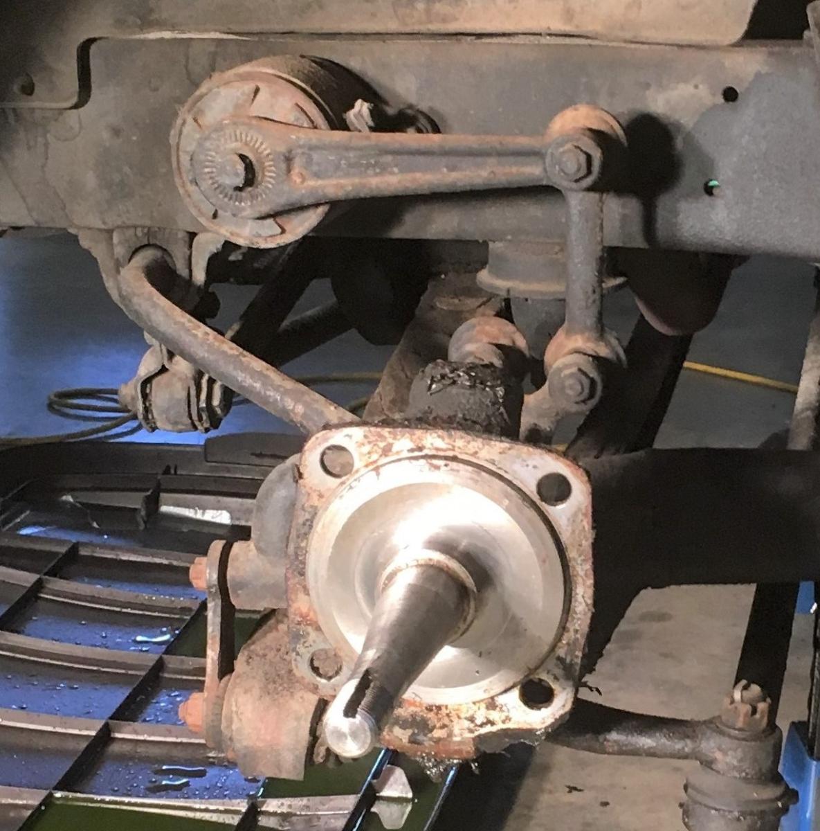

Any part on the car that looks like this front or rear? The one in the picture is a front found on 41-47 and some 1948's.

The shock that 42Deluxe has a picture of is what the early 48s had and of course looks nothing like a modern tubular shock. Apparently at some point in the 48 year Ford changed over to tubular shocks. You should find one or the other as it is doubtful that the car would not have any.

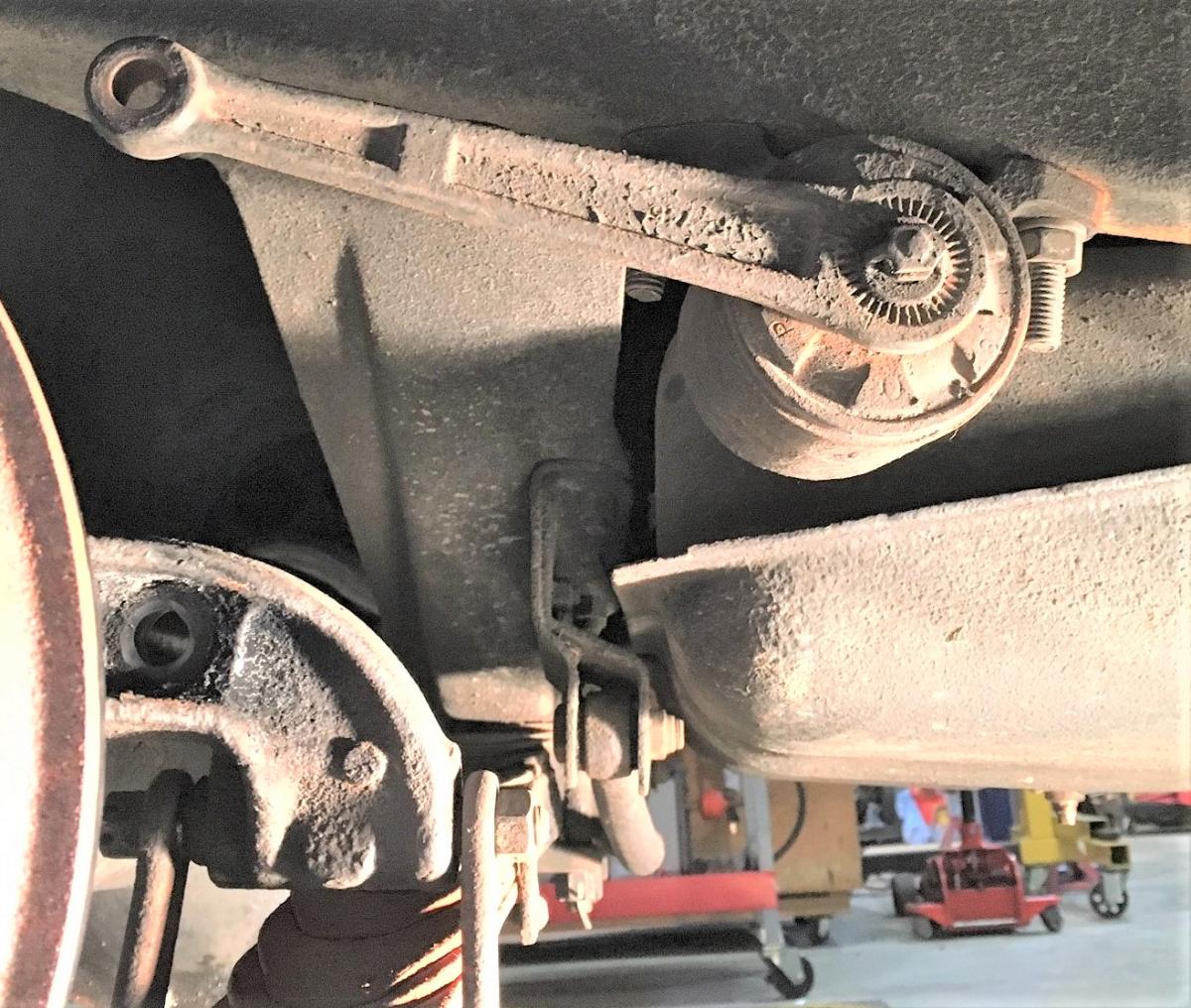

Yes..this is what I see Thanks

This style of shock can be rebuilt. They are an adjustable shock unlike the tube shocks. New Old Stock can be found on Fordbarn and Ebay along with this site. If I recall correctly the numbers on the front arms are F924 and the rear are F881. There is a right and left also if I am remembering correctly.
