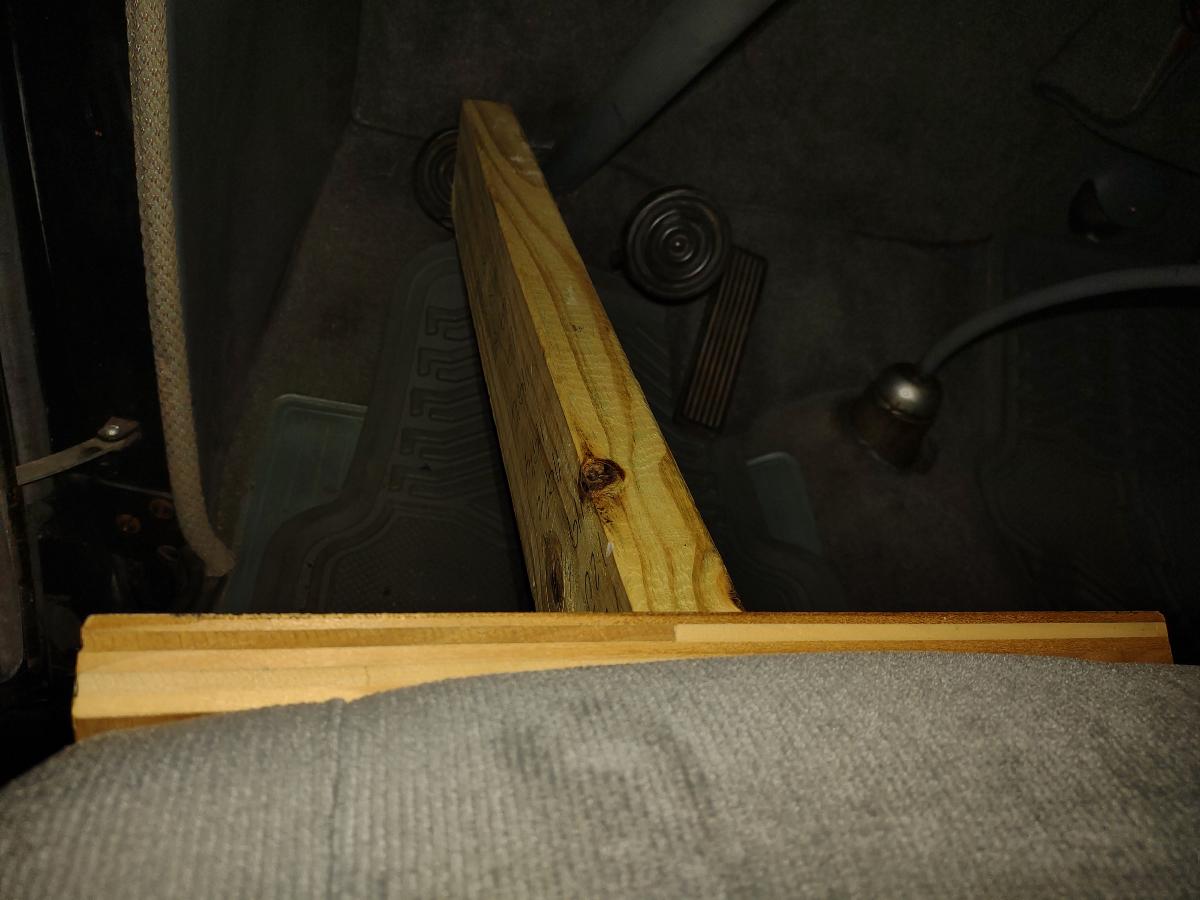

Zoopie36, the attached pic shows the clutch disengaged with a support against the front seat. This support was provided by the former owner. He explained if the car was going to be stored for any length of time this would keep the clutch disc off of the flywheel. As 40cpe explained this will keep the pressure off the disc. I use this support after every cruise since I never know when the next cruise will be.
Ray
