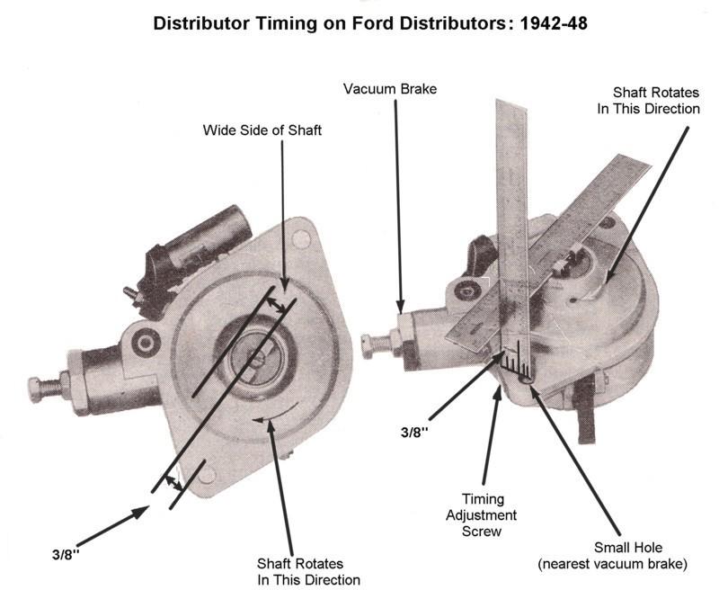

As suggested check the vacuum first. However should you ever need to adjust the timing it is fairly simple and I suggest you look for the instructions in a service book that you may have. Basically it requires you to remove the distributor from the car and then using a couple of straight edges measure the distance between the tang on the back of the distributor and one of the bolt holes on the side. Sounds complicated but really isn't if you have a book with a picture.

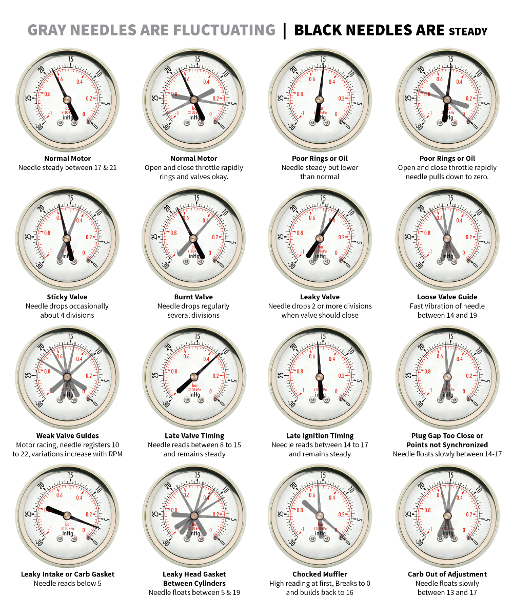

09-06-2022 @ 7:39 AM
John. Some good suggestions above. The attached chart shows "poor rings" to be very close to "late timing" in the readings. The Ford shop manual lists the compression for a 59A, to be 100PSI, so a compression check would be recommended. Ensure the battery has a good charge, and the throttle is wide open during the testing. The BEST way to set the timing is to send your distributor out to one of the specialist that do ford distributors. You can do it yourself with the attached info. I use an unlit handheld propane torch to check for vacuum leaks. With the engine at idle, partially open the torch valve and move the nozzle around the carb base, vacuum hose and intake manifold to block gasket area. If there is a leak, the engine will speed up.
