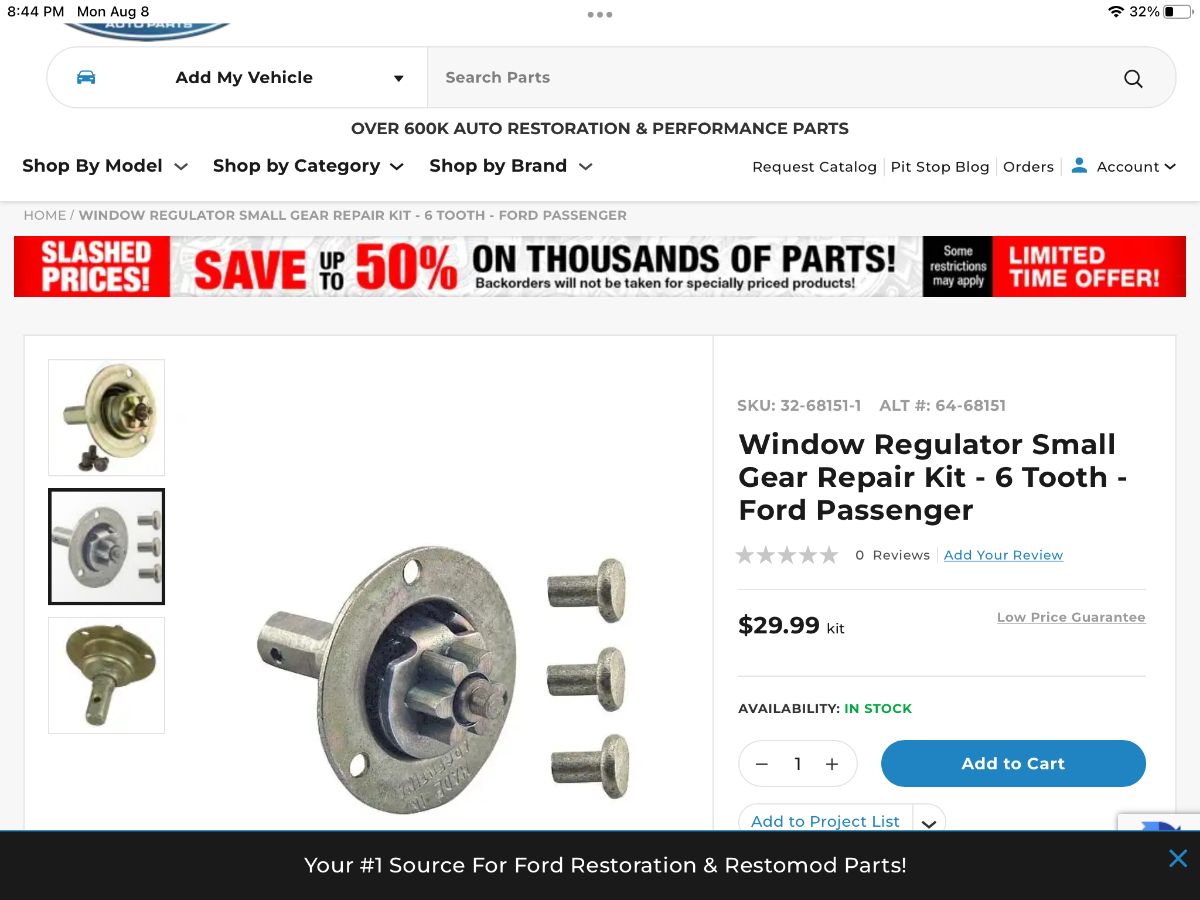

I am down to 1 functional window crank in my 1941 2 door sedan. Obviously the square drive part gets very brittle, is there a fix other than replacing the regulator? This is a solid, mostly original driver, just looking to keep things functioning. I got the broken square piece out of the handle, can the square drive be replaced with 3/8” square stock? Is the part in the picture what I need? How do I know if I need 5 or 6 teeth?

That part you display may or may not work. You would need to take your regulator apart and count the number of teeth on your regulator pinion gear. Use your V-8 times and call Regulator Roy who advertises in there. He may have a NOS regulator or the parts to fix yours.

There are several gear tooth counts, you have to disassemble and count. What you show in the photo appears as if it will work, even if you reuse your good gear. I have never heard of the square shaft breaking, usually the gear strips, but there is always a first. If your gear is still good it appears the shaft from this kit will repair your regulator. When you do the repair clean and then relube (don't use white grease it will get hard) There is also a circular spring in the cup that covers the assembly.
