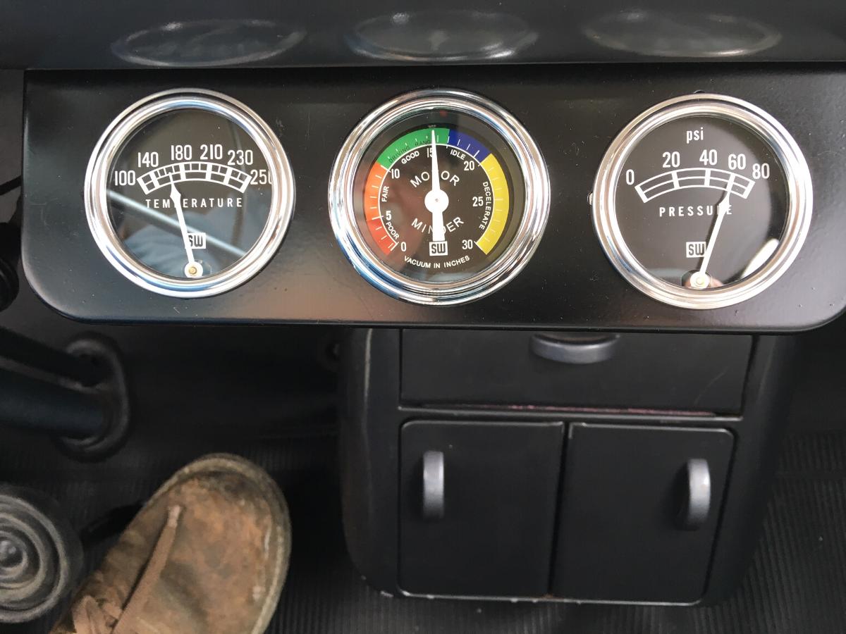

Regarding the comment on high oil pressure, my stock 59AB runs at 20 psi idle, and 60 psi at speed on mechanical the mechanical gauge. The dash pressure gauge shows 1/4 at idle, and just over half way at speed. I was initially using 15-40, then switched to 10-30, because I thought the pressures were too high. Changing to a lower viscosity made no difference in the pressures. Note: It is best practice to disconnect the lead to the coil when testing is done on the gauges, so there is no damage done to the coil or points.
