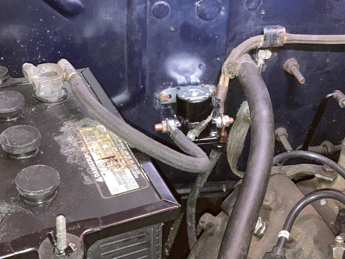

Thanks for responding. I'll try to get pics later today. I connected the new solenoid the same way the old one was. Thinking the new one might be faulty, I reinstalled the old one. I get the same results with both.
I have a negative ground set up. So the positive battery cable goes to the closest terminal on the solenoid. The starter cable goes to the opposite large terminal and the small wire go to the small center terminal.
I have power at the end of the postive cable but when connected to the solenoid terminal I get no reading on my meter. I have readings on my other large terminal and the small terminal. This has happened on both solenoids . Everything worked on the car prior to this. Your help is appreciated. I'll wait for your response before proceeding.

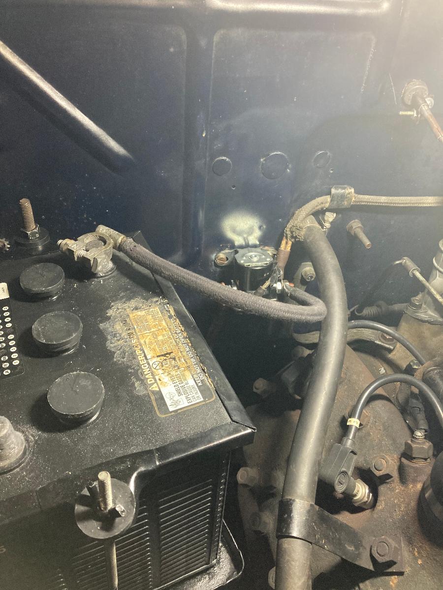

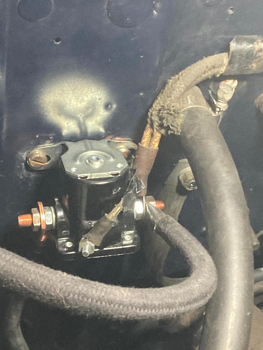

Here are a couple of pics showing what's hooked up. I would think that the repro solenoid would be the same inside as the original for the car in question. As it is the original one isn't working now either and I don't know what changed. That's why I asked about polarity
06-21-2022 @ 7:01 AM
Your solenoid is not wired correctly. The connectors from the loom should be connected to the side that the battery cable is connected to.
With a Ford type solenoid, the battery cable connects to the driver's side of the solenoid along with the wires from the loom. The starter cable goes on the passenger side of the solenoid.
The starter button connects to the center terminal. The solenoid coil gets the hot side connection from the left side of the solenoid and the grounded side of the coil from the center tap. When the solenoid is connected correctly, the center terminal should have 6 volts until the starter button is depressed.

What I see in the photo, that the main electric wiring is on the wrong it should be connected to the same side as the battery terminal on the solinoid so it supplys elect to the rest of the car,
why would you change the polarity, it is not needed and cause many problems.,???
All gauges will most likley not work correctly or not at all and might burn out,???
might read opposite
coil will need not work 100% not unless you reverse the wiring on it,,
