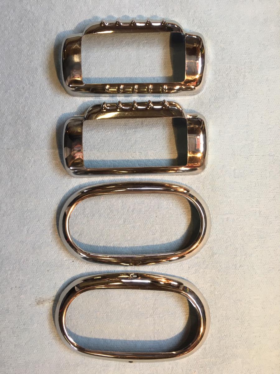

Peter NH has good advise. I did a lot of the trim on my '46 Coupe by myself with guidance from You Tube. Trim for the lights came off, got polished and put back on. With the side trim, I masked off both sides of the trim to protect the paint, then used a 4" buffing wheel with polishing compound to polish the trim. Removed the tape and it looked real good. Simichrome (sp?) works well on a rag, to get into places where you can't get at with the buffing wheel. As Peter posted, be patient, and it take time to get good results.
