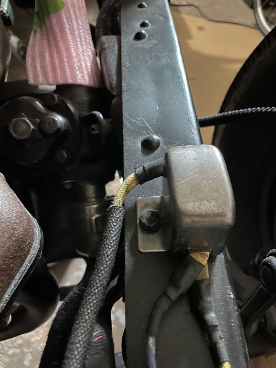

If you have the original type relay (it uses the same mounting bolt as the horn bracket) it has 4 terminals. The horn wires go into the 2 top spring loaded terminals. The next terminal down is the power source terminal, The heavy yellow and green wire is soldered there. The bottom terminal is for the horn button wire connection. The eyelet on the blue and yellow wire from the harness is soldered to this terminal and the bullet connector is connected to the black wire coming out of the bottom of the steering column. If you have the aftermarket type horn relay ( https://www.dennis-carpenter.com/trucks/electrical/horn/7ra-13853-horn-relay ) the terminals should be marked with a 1 letter stamp.

My early, original relay (same as shown on page 4-32 on the 38/39 book only has three contacts. So the wires that need to be grounded aren't connected here? Are they grounded to the horn mounting bolts somehow? My car is a standard, but I think the wiring harness I have is for the deluxe because the horn wire connections on the harness are too short to reach the centered location where the standard horns are mounted. Is there a difference between the standard and deluxe harnesses? Or were jumpers used between the harness and horns? Thanks!

Once Ford went with the relay, it did away with the two wire motors. The one and two wire horn motors have the same form factor so they can interchange with the horn bodies. But you can use a two wire horn motor with a relay system; you just have to find a way/place to ground one of the wires. There is no factory place. As the book explains, the relay was on the frame both for standard and deluxe. However the horn locations were different so I would suspect the wiring to the horns to be different
