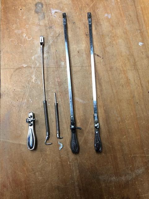

Here is a picture I took. The spring is very compressed and has no play to move the wiper arm up and down. So I'm having trouble to know how the L wire goes onto the post and which direction the C shaped part faces. Thanks again.

Horse shoe goes on top.

Got it. Thank you. I think maybe I need to push harder on the spring to get the arm to move up.

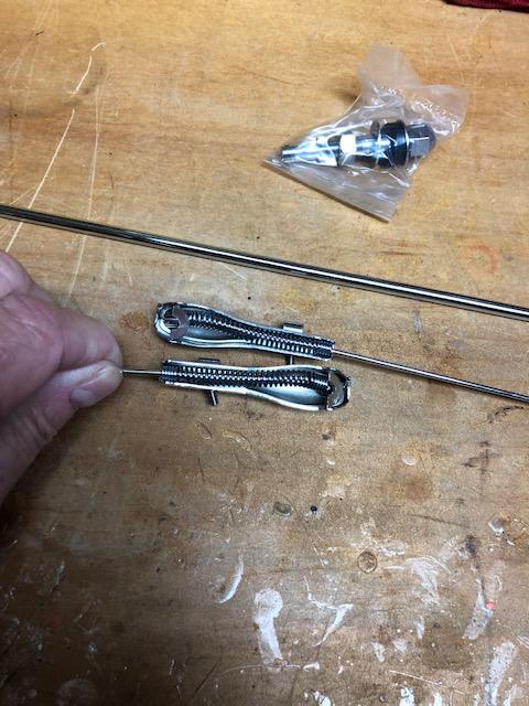

Well, I still have not solved by installation problem for my 36 Ford wiper arms. As you can see from the pictures below, it doesn't appear to me that the parts are even the same. I bought this kit from Obsolete. The wiper arm is shorter, the spring is longer, and the hook where it goes into the post is an entirely different shape, more of a zig zag that a plain L. Also I had to swap out the saddle because the other one was too small. So I'm not sure where to go from here. The hook that goes onto the post sticks out more on the side so there is no flex or play in the arm. And the spring is at full compression so I can't get the saddle to slide down the post far enough to seat. Am I doing something wrong or is this really a bad part replacement? Any suggestions? Going to a swap meet this Saturday. Maybe I can find an original wiper arm there.

I would call other V-8 parts vendors like C and G Parts or Third Gen Auto. They advertise in the V-8 Times and in our links section in the left menu of this site. The parts that were sent to you do not look correct to me or are a poor reproduction.
