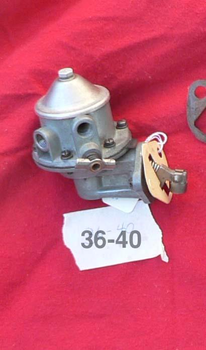

TomO |
04-24-2022 @ 9:45 AM
Posts: 7386
The diaphragm return spring controls the fuel pressure. It is unusual for the spring to increase it's pressure. I don't know where you can get a new spring and if you do disassemble the pump, you should install a new diaphragm. The valves in the 1936-1940 fuel pumps are unique to those years and are not easy to find or replace properly. I strongly advise you to have the pump rebuilt by some one with lots of experience in the peculiarities of the pumps. It will save you a lot of headaches. I have attached a photo of the 1936-1940 style fuel pump. You will notice that the output port is lower than the input port. If this is the pump that you have, it should be rebuilt. If the input and output ports are equal in height, and you are not having your car judged as a Rouge car, I would replace the pump with a new one. If you are going to have your car judged as a Rouge car, contact Charley for an original pump. If you are concerned about USPS losing your fuel pump, ship it UPS or Fed EX and insure it for $400. That way if they lose it, you can get a replacement. The fuel leaking at the base of the carburetor could be a carburetor problem other than float level. Your power valve could be bad or your needle and seat could be failing, or your float could have a small leak.
