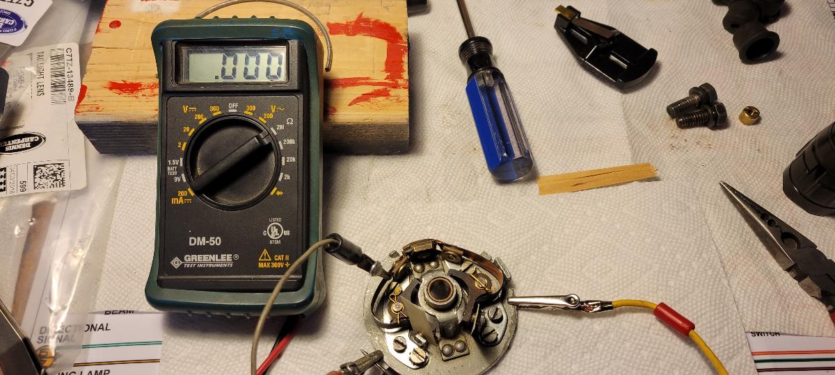

Thanks for the photo. It helps a lot in understanding your problem.
You definitely have a short and it looks like it may be the copper strap on the left side (in your photo) points is contacting the timing screw socket.
If that is not your short, remove the screws holding the spring and copper strap from one set of points and check resistance again. If you still have a short check resistance with both sets of points disconnected. If you still have a short, it will be in the connector block. Examine it and the flexible straps to see if any of them are touching the contact plate.

I had a problem like that once, it was the little brass flexible connectors that go from the coil terminal to the points spring mounting, one was out of shape and was contacting the screw mounting lug and shorting out.
worth a look.

Tom, reassembled the distributor and re-attached to engine. With dwell meter on lead to distributor and other on ground, cranking the engine produces no measurement. Dwell meter is an older analog type but works well as I recently used it on my 1969 F100 pick up. I would think the lack of dwell measurement would coincide with a short on the breaker plate. Would you agree? Attached is a picture of the multimeter probe attachments to the breaker plate with ohm meter at max resistance. My understanding is that it should read 1. with good insulation. As you can see it is reading 0.000 which I interpret to indicate a short in the plate. Like to hear your thoughts. Thanks.
