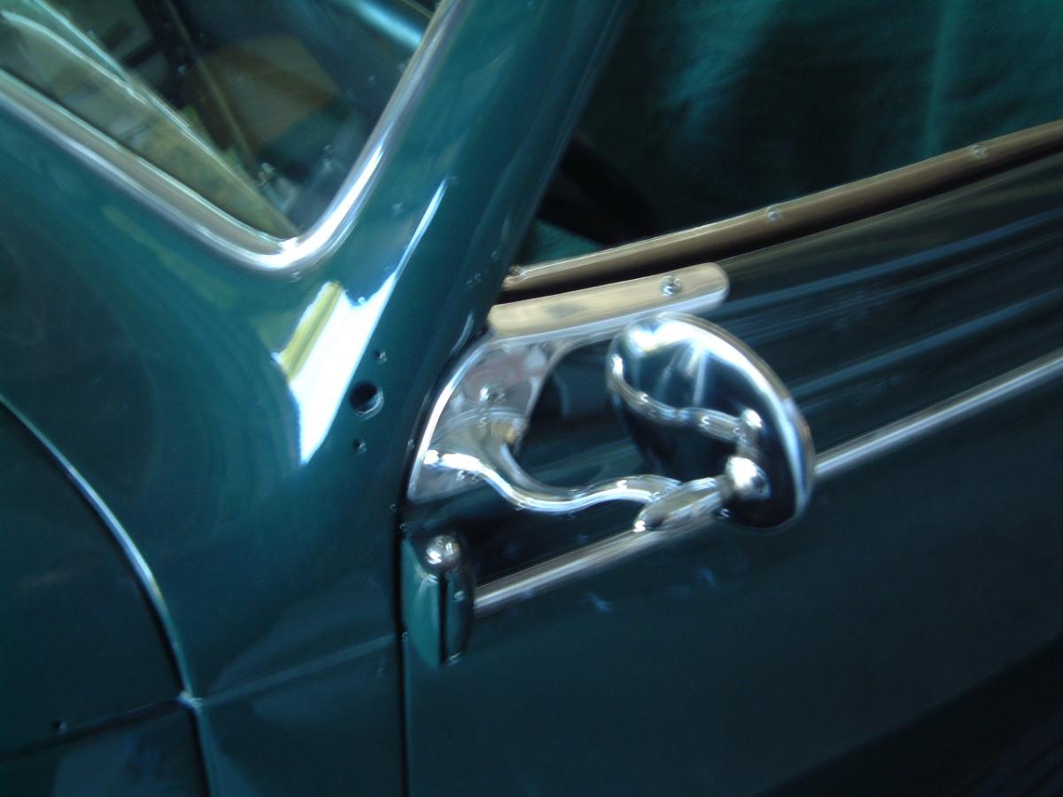

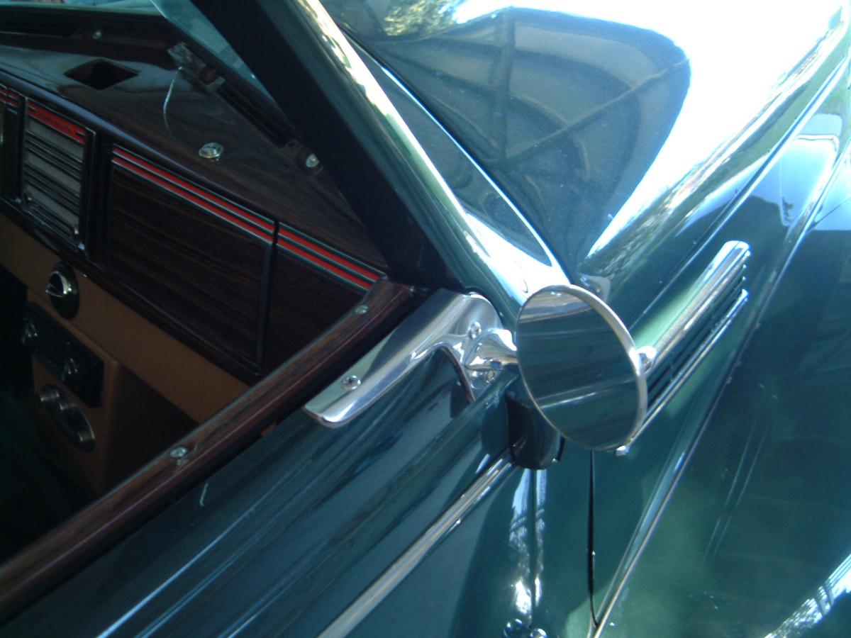

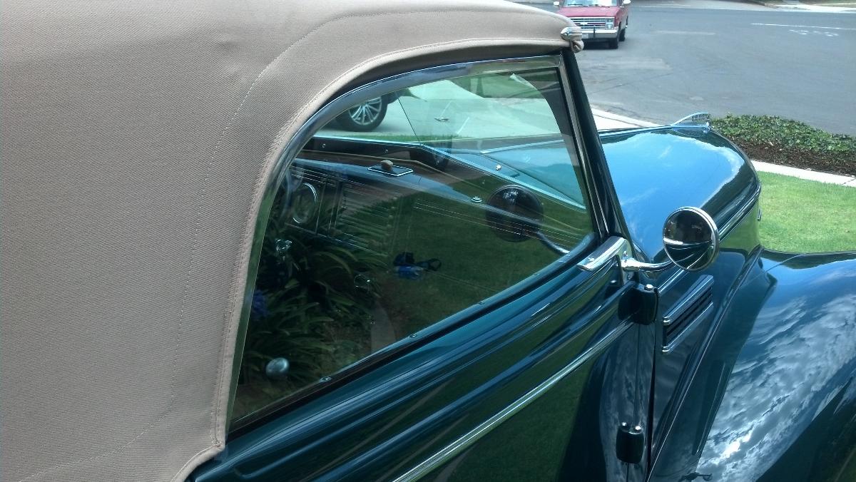

Attached is a pix of the mirror mount brackets I made for the left and right side of my '39 Plymouth convertible coupe.
Ford and Plymouth both had Briggs Bodies, therefore, they share a lot of similar features.
If some of the purists complain about my mirror mounts at a car show I tell them my car was built at the Chrysler plant in California, therefore there are variations between Eastern and Western cars.
Bill

wmsteed, wow,those are verry nice mirrors. polished alum.? Tom.

The '37-41 DPCD open cars, unlike the Fords, had factory applied wind wings that were attached to the outer door skin via 4 1/4- 20 bolts.
I have a set of accessory wind wings that came with my '36 Ford coupe, I never did like the looks of them on my car so they have not been on the car since 1952.
The wind wings on the '37-41 DPCD cars were very well made, heavy cast stanchions attached via 4 -1/4-20 bolts. I made a hardwood buck to form the sheet aluminum over. Attached the mirror's and bracket with similar DPCD counter-sunk bolts and rubber gasket.
I use convex type mirrors, in a size large enough to cover the original mirror, which really improves the visibility on the right side.
Bill
