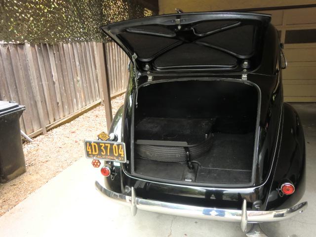

Does anyone have the details on the shelf that was above the spare tire?.. I want to build and install one. A pic if someone has one would be great.
MG
03-13-2022 @ 7:44 PM
Posts: 1301
This picture is the best I can provide. I can't provide dimensions as I no longer own the car.

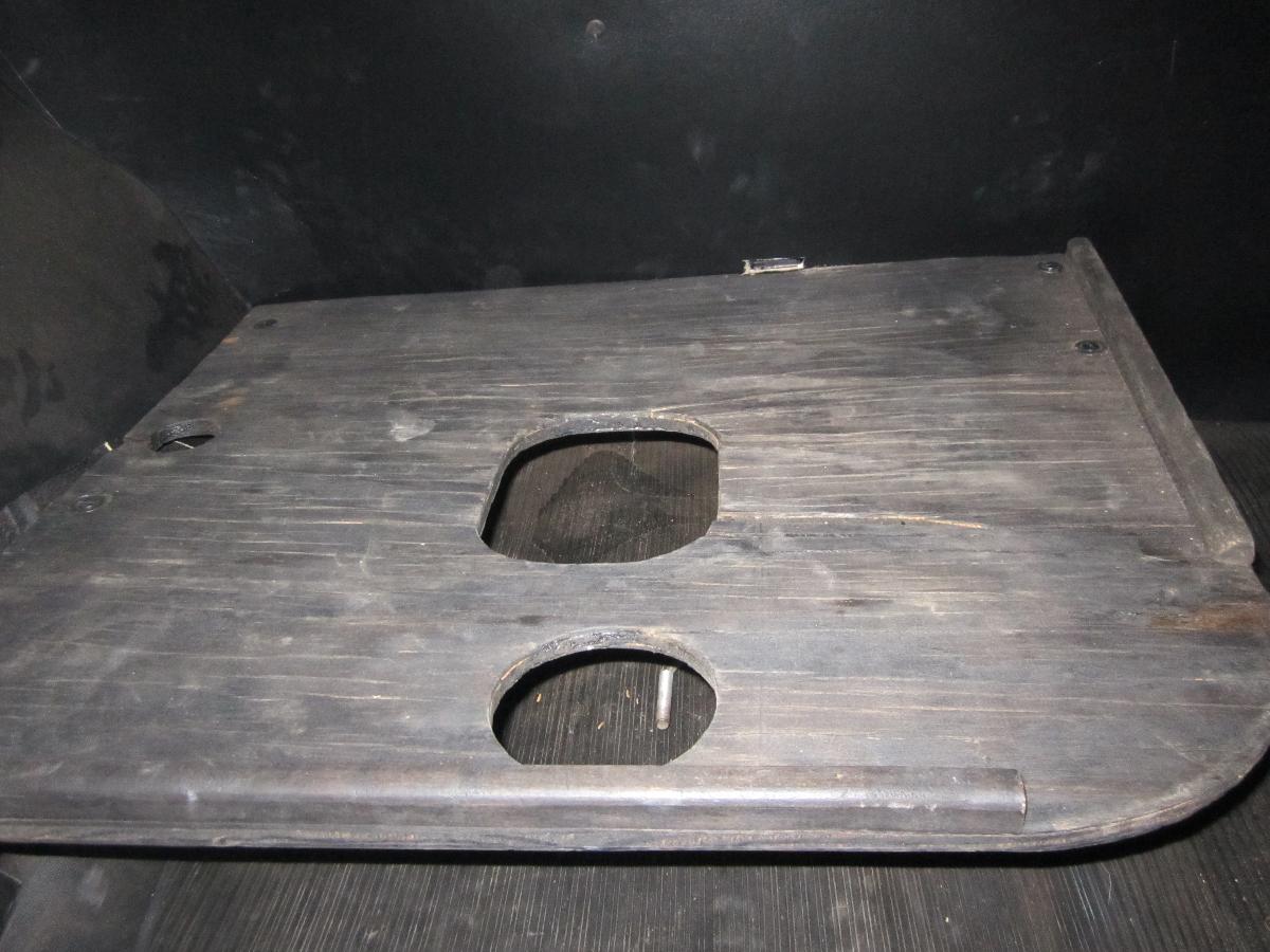

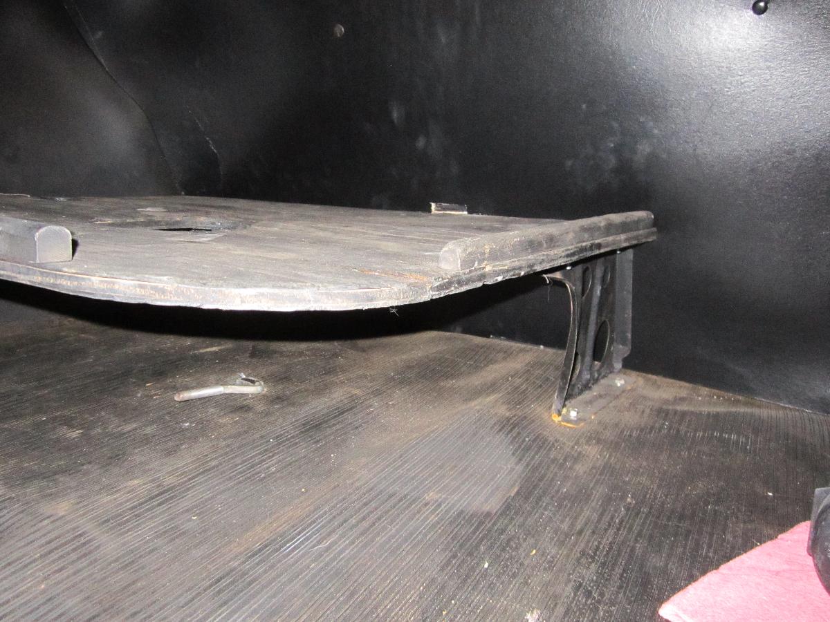

Hello,
I have a 37 Fordor Sedan. Attached is a single pic of the wooden piece. I have several other pics but they are too big to load. I can send them to you via email if you want. Can also take more pics. It may helpful if I make a paper template of the piece and send that to you, so you can have exact dimensions.
The wooden piece is mounted in the left side of the trunk. It has several mounting points on the left hand side where the wood sits the body. On the right side, the piece mounts via a standing spacer that is attached to the bottom of the trunk. Interestingly, I have seen two different types of spacers, one of wood and one of metal.
Anyway, glad to help out any way I can...
