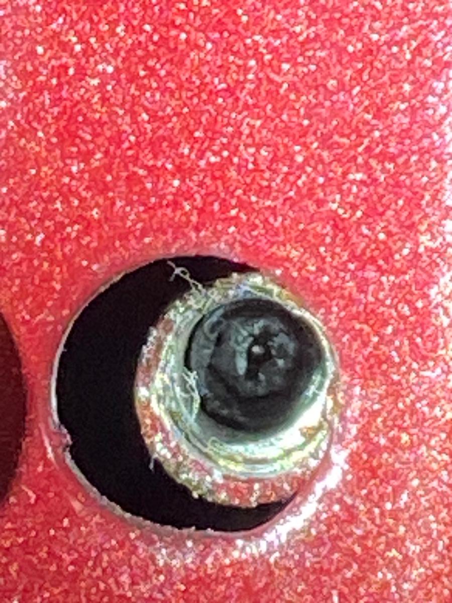

Question, does anyone know if there's a special tool used to remove/loosen the setscrew holding the lockset in place?
Otherwise, how does one remove the lockset?
The photo below is a view from the actual door frame just above the latch into the site hole accessing the setscrew.

No special tool. These can be very hard to remove. On my 39, I broke off half of the head and then had to drill the screw out.

It's a strange looking screwhead almost like a very small hex with a slot.
I'm trying a avoid drilling it out. I bought some of this Superzillow penetrating spray to hopefully ease it up a bit before using a tool to try turning it.

I have never attempted to drill out one of these screws, but if I did attempt it here is what I would do:
1. It looks like the screw is deep enough you may be able to use the hole to guide the drill bit; use a drill guide to center the bit on the screw,
2. use a left hand drill bit to drill out the screw with the drill turning counterclockwise. Hopefully the bit will catch and back the screw out as you are attempting to drill through it.

Ok, Boys & Girls, mystery solved!
The set screw is actually a 1/8th inch allen-head setscrew.
Apparently, somewhere along the way the slotted setscrew was abandoned and switched out and upgraded to the allen, I'm thankful for that.
