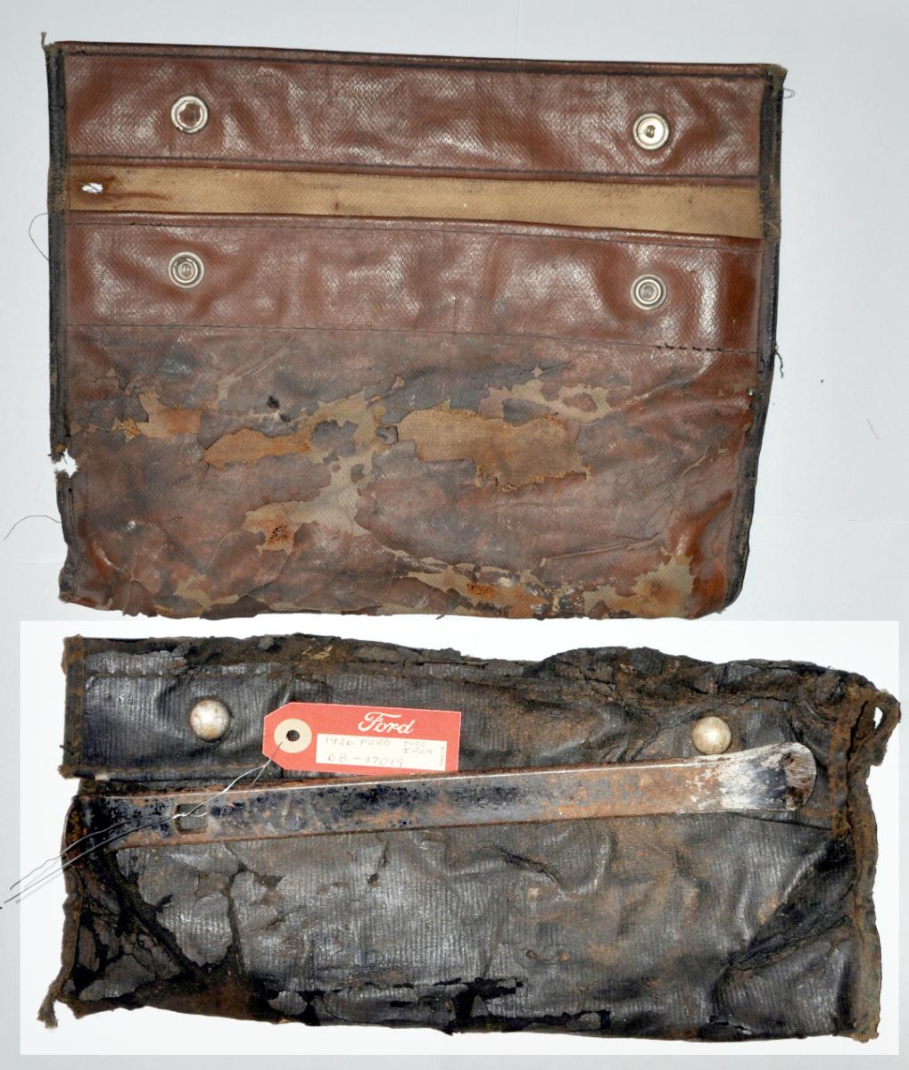

A leatherette tool bag (B-17005-A1) was designed to hold the small hand tools. While there were two versions of this bag, the later A2 design described below was seldom used.
According to engineering drawings, the bag was made from M-2388, leatherette, or when available, surplus rubber, whipcord or leather. In other words, any suitable material was most likely used to produce this tool bag. Thus, colors varied but normally would have matched scr*p leatherette from the production line.
The tool bag most commonly produced was the A1 design. Approximately 11" wide by 6" high when closed, this bag had two 5/8" diameter metal snaps, plated either S6, S7, S8 or S28 securing the flap. The flap’s approximate dimensions were 11" x 2½".
Rarely observed today, even in extremely well-preserved vehicles is the A-2 design. Made from identical materials as the A1 design, this bag was approximately 12½" high and 7" wide when closed. The end flap was approximately 7" x 2½" and had only one snap, placed in the center.

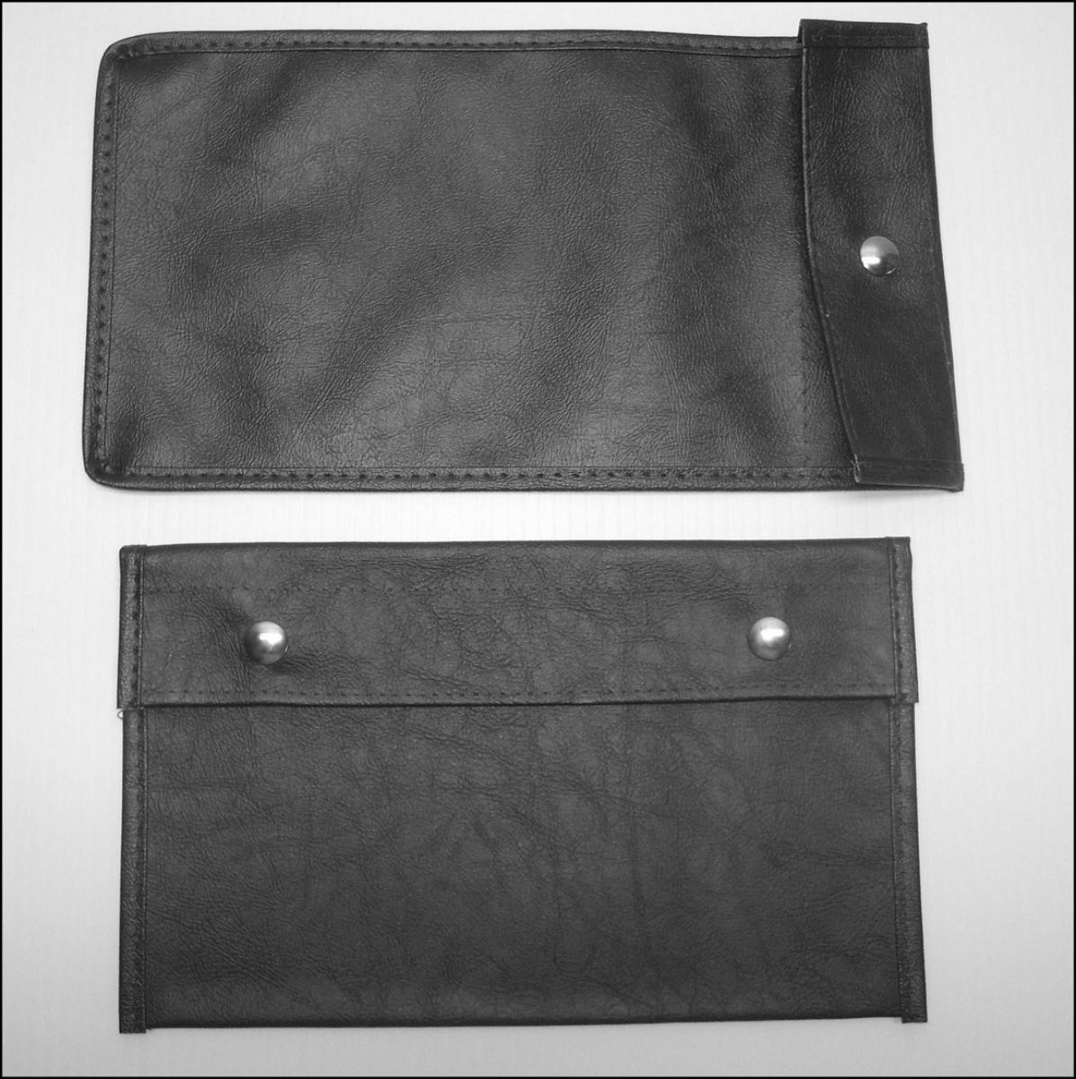

03-25-2022 @ 8:26 AM
Posts: 3
Joined: Feb 2010
checking in to see if you found a 1937 Ford tool bag. Sending a picture of the Ford tool bag that I make. I use USA made vinyl top material

mh60r
03-29-2022 @ 2:05 PM
Posts: 3
Joined: Feb 2010
Model A tool bag is different from the V8 tool bag. Model A bag has "short" grain vinyl material and V8 is black "long" grain vinyl material. Carol
3w2
03-31-2022 @ 5:32 AM
With respect, as often as not, surviving original tool bags from the early V8 era were made from surplus artificial leather upholstery material such as the copra drab pyroxylin material used on 1932-'34 open cars, for example, and not necessarily made consistently with either the long or short grain black top material.
