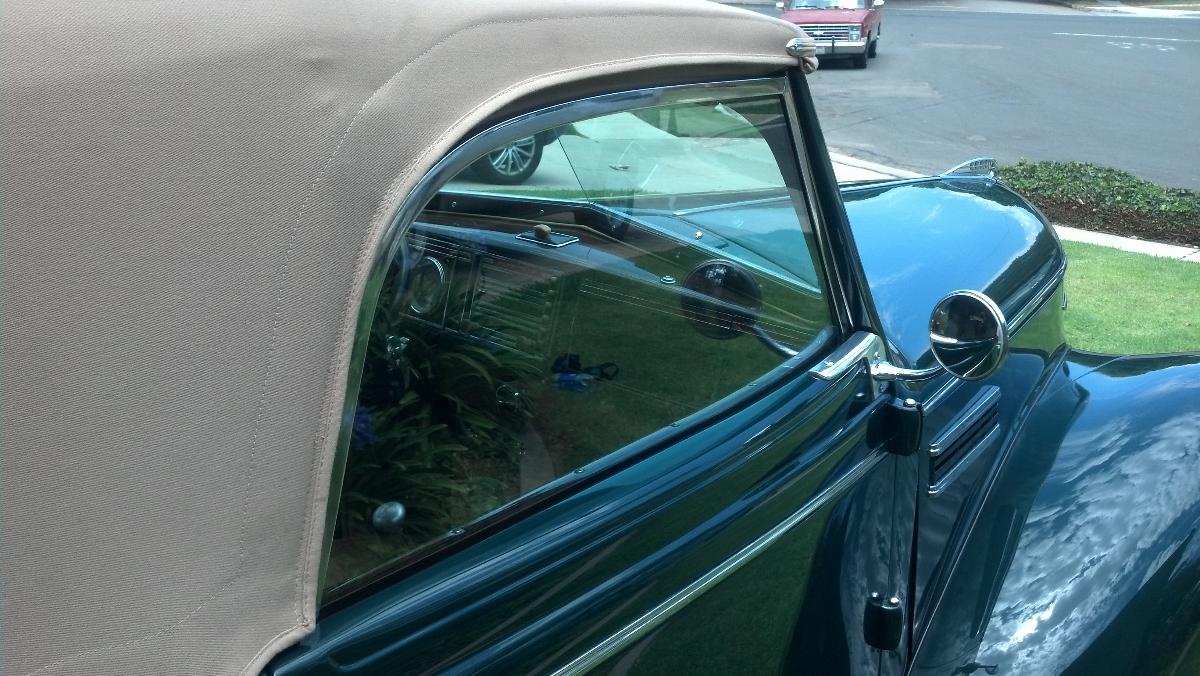

Hello,
I have a 1940 standard Fordor. I bought two peep mirrors from Mac's. They are 4" diameter, straight arm 5" long, clamps on door flange with two set screws. Mac's catalog claims they can be used on LH or RH side. Mirror on left side can easily be adjusted to see appropriate traffic from driver's position. However, I am unable to adjust RH mirror to view traffic on right side of car from driver's position, regardless of where on the door flange it is mounted. I have hunted online for an acceptable mirror to no avail. Any suggestions as to where to find a mirror suitable for my application? Or suggest what needs to be changed or altered to above mentioned mirror.

Maybe a convex mirror face would help? Would be more like what we are used to in a modern vehicle to see traffic in the next lane. I believe 4” diameter stuck-on mirrors are available.

Posts: 613
Jaychicago... Hit the nail on the head, a convex mirror on the right side solves the problem.
I use accessory glue on convex mirrors, that are as close as possible to the mirror head, attached over the existing mirror head. Been doing this for years, works perfectly.
