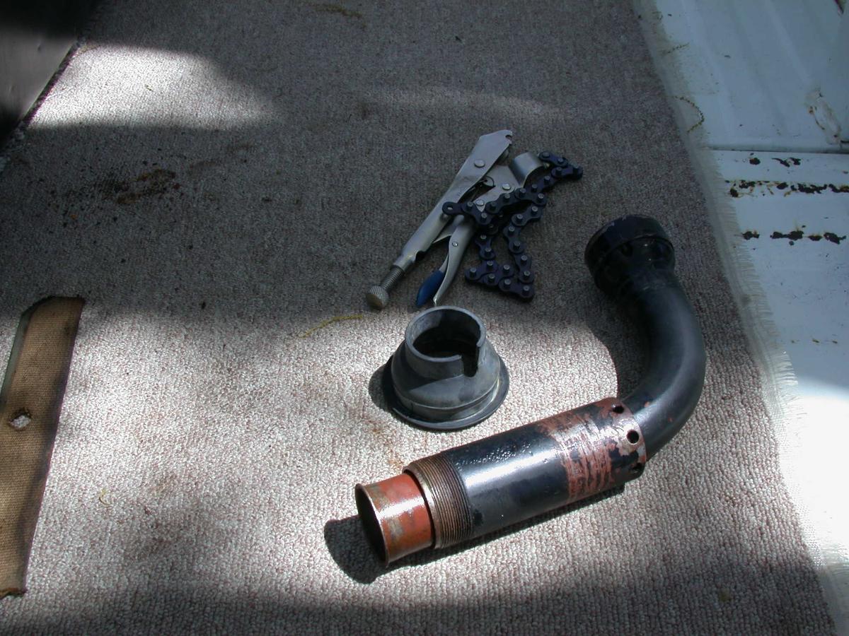

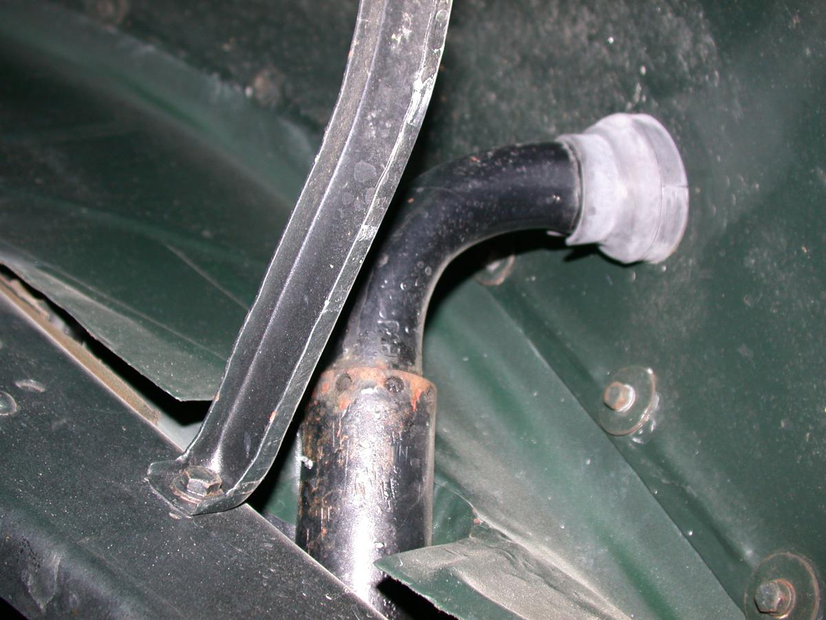

I am in the process of removing the fuel tank in a 37 Phaeton. While the PB Blaster is working on the drain plug I started to look around at the filler attachment. Apparently I have a early style filler arrangement where you have this long threaded nut that attaches somehow to the tank and then threads to the curved metal filler on the fender. I went ahead and PB blasted it last night but now I am wondering if I need a special tool to remove it since I saw it had a pattern of holes around its circumference. Can anyone advise how to remove this filler attachment arrangement? If I need a special spanner wrench please advise where I can get one.

You do need a spanner wrench. You can figure out the approximate size by measuring the sleeve. They are available from many sources, including Amazon. On Amazon just search for "spanner wrench" and several are available.
I bought mine at Sears (RIP) years ago.
Be sure to soak the threads with a penetrating oil such as Kroil or PB Blaster and take your time. It should come loose fairly easily.

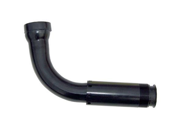

Thanks for the info and advisement. I still am not understanding of how the threaded nut attaches to the tank itself. Does the nut have an internal thread that mates to a male thread on the tank? On the other end of the nut, I assume it has a female thread that attaches to a male thread on the curved filler tube that goes to the fender....? If this is the case, I dont understand how you can unthread one of them without tightening the other. With the tank installed in the car I cannot see what the nut/tank connection looks like. Please advise.

This one is from Drakes.
BRL
01-29-2022 @ 11:43 AM
Posts: 113
Joined: Oct 2021
Hi:
OK thanks 37Sedan...I understand how it attaches now.

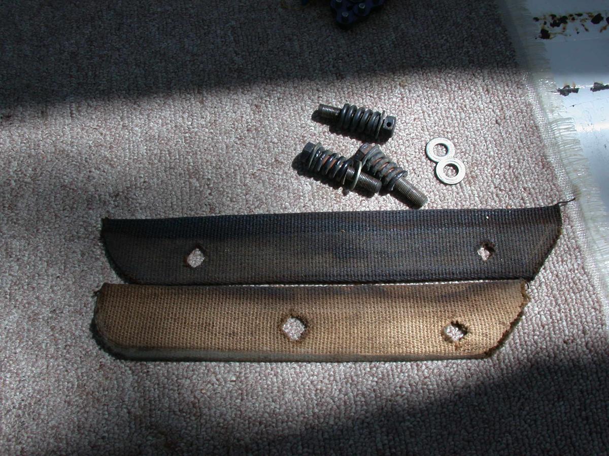

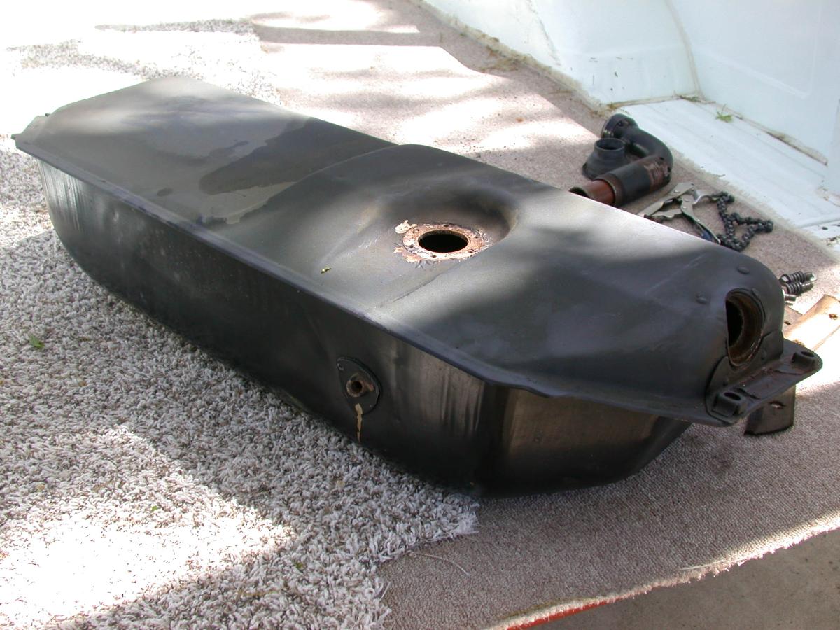

So after a couple of months of soaking the filler tube/tank attachment threads with PB Blaster and tapping with a hammer the filler neck finally agreed to unthread. I used a vice-grip chain clamp(pliers) to grip and turn. I still needed a 1 foot long cheater bar to get it turning. There was not a lead washer between the filler tube, so I guess I need to get one. Tank is off to the radiator shop to get a good cleaning. Note my photos of hardware...does it look like I have all the correct hardware? Anyone have any advice for any other maintenance things I should take care of while the tank is out? I have the carb, fuel pump, and sending unit rebuilt and ready.
