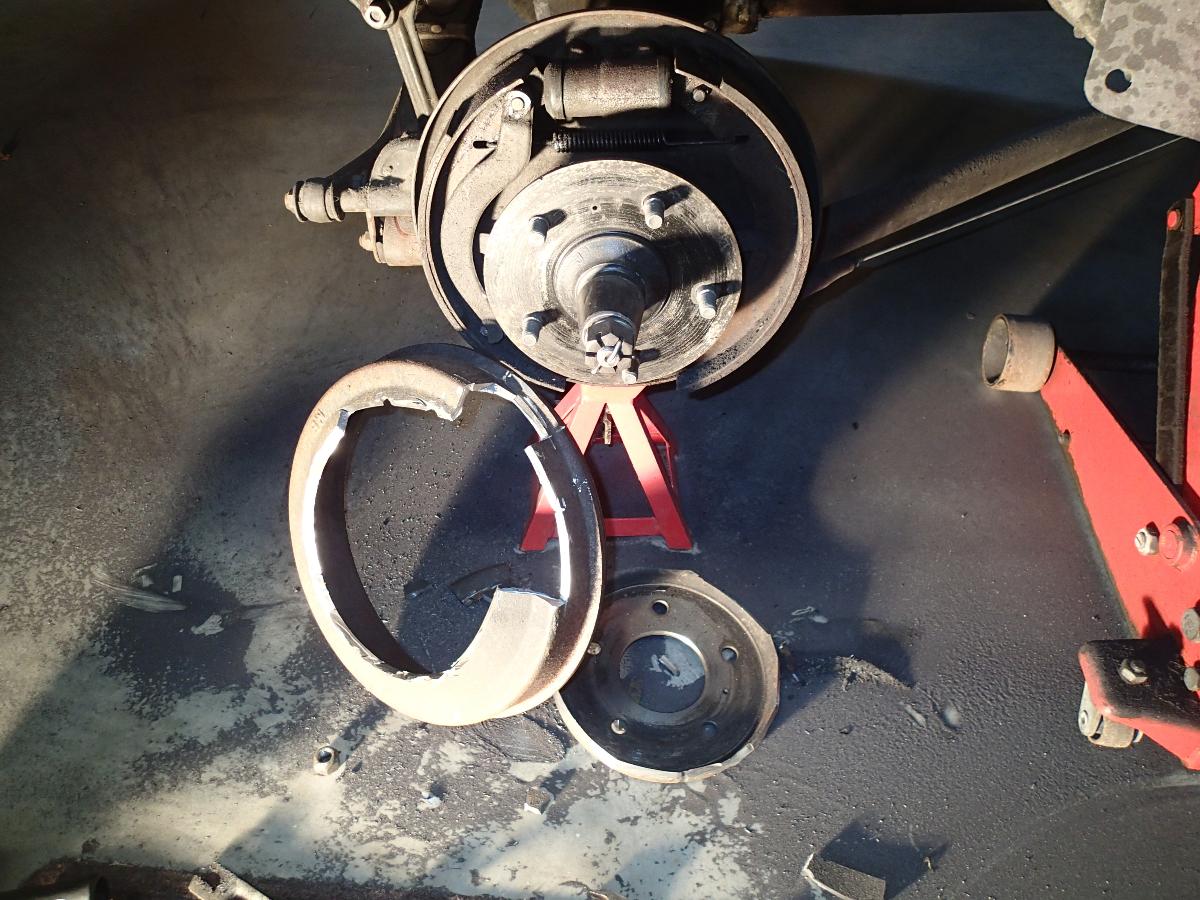

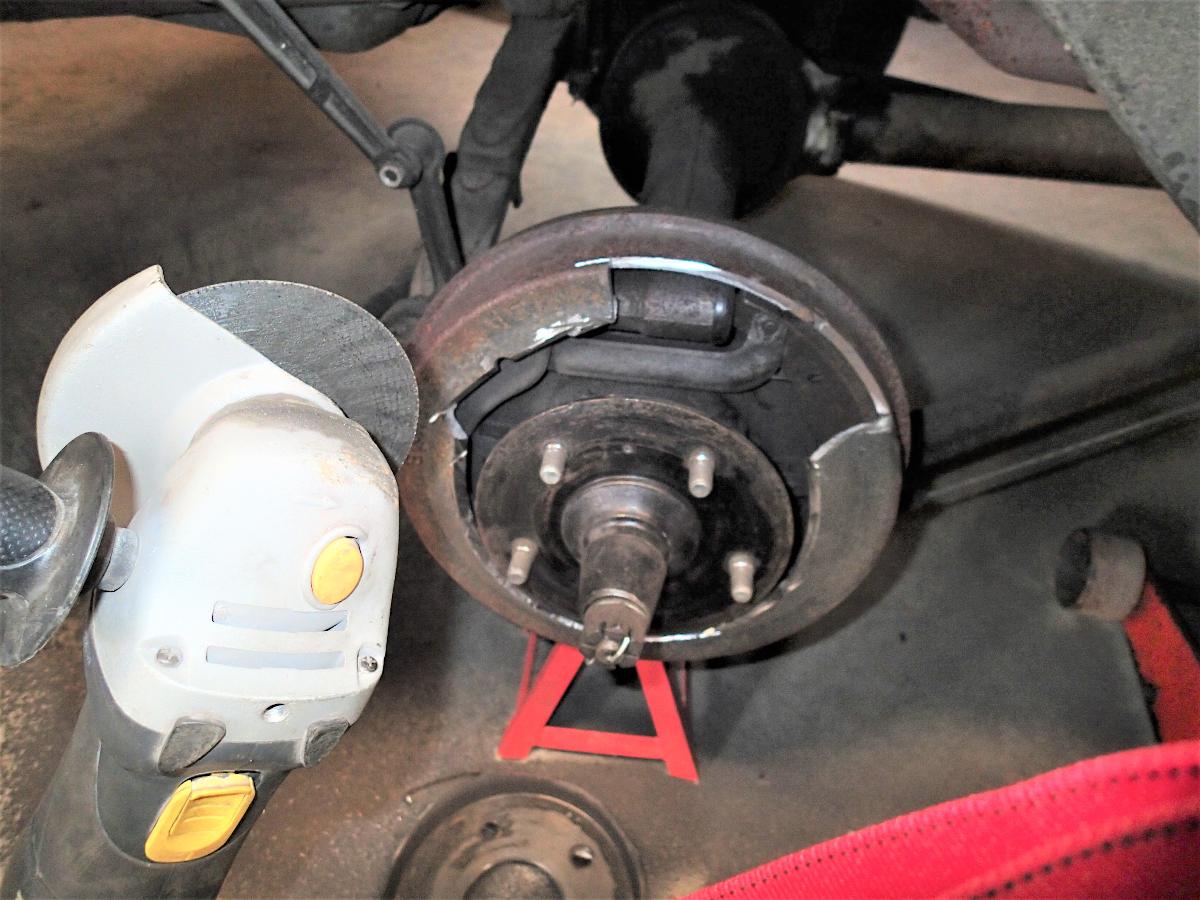

Shortly after getting my stock "46 Super Deluxe Coupe, the brakes started dragging. I put the car up on stands to check all the wheels for free rotation, and the right rear was the culprit. First check, was for slack in the E-brake cable.......lots of slack. Off with the wheel, and the drum could only be turned by levering it with a pry bar. Beat the rim of the drum with a 5lb dead blow, urethane hammer...... no luck. So, out with the angle grinder and Zip-cut wheel. Several cuts later, I had the drum off. The problem, was that both pistons in the wheel cylinder were seized, holding pressure on the drum. The end result was having to buy a new drum, and in the end, decided to go with Boling Brothers brake kits front and back. I know it's not "stock" anymore, but they work great, and all new parts. The question is..... did I miss a way to remove the drum without surgery?

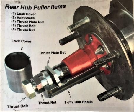

I probably would have tried the things that have already been mentioned by others here to free up the drum as much as possible. Then use a KR Wilson type hub/drum puller to pull the hub & drum assembly off the tapered axle. I would have exhausted all possiblities of getting that drum off before cutting it off.

I did back off the mid shoe cam style adjusters, but still too tight. The shoes are mounted on non adjustable anchors at the lower end, so nothing there. I hadn't thought about loosening the wheel cylinder bolts. That may have worked. One of my car buddies suggested heating the perimeter of the drum to expand it, but I passed on that idea. I hadn't thought about a hub puller (which I have) but thinking on it, the shoes would not have slipped sideways in the drum, due to the ridge on the outer edge of the shoe path.

Maybe I missed something but did you try to use a good hub puller on the hub/drum? The reproduction KRW one seems to be the best.

51woodie
01-30-2022 @ 10:40 AM
Charlie. The drum on my '46 can be removed from the hub, if the shoes are backed off. I have a Vintage Precision hub puller, but I couldn't pull the drum, so pulling the hub and drum together wouldn't work. That is why I cut it off and replaced it.
