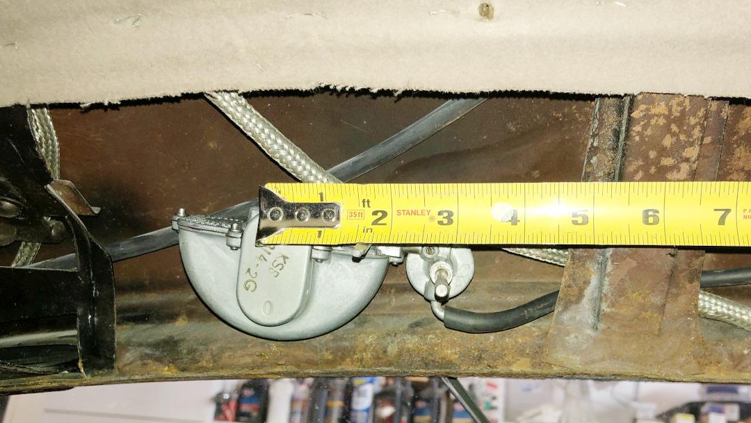

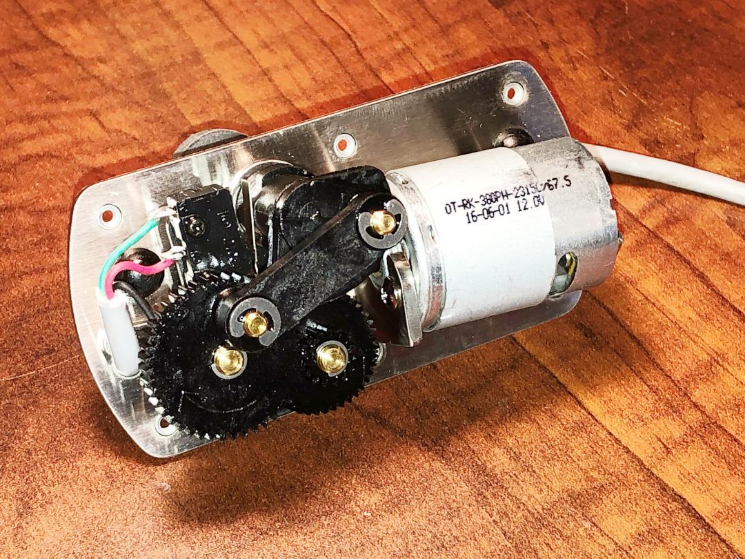

If you try two separate motors, the wipers will hit each other, been there, tried that. I have been searching for a suitable electric motor for my '36 5 window. The clearance between the factory hole for the driver's side and the roof brace is 4 1/2 inches. I have searched for all kinds of wiper motors, all are too big. One would think that a KIA or Smart Car wiper motor would be smaller, but they are the same as the Jeep motor. I even looked at snow mobiles, they are too big as well. I even wrote to the maker of the Mighty Wiper, (not so mighty, the electric motor is tiny) and it won't power two blades. It will barely power one. I asked him to put a larger motor on his existing plastic gear motor, but that would probably tear up the plastic gears. I have also looked at the reverse solution, what about a stronger vacuum pump. I purchased one made for booster brakes and one of the small round black vacuum tanks, it still would not power my recently rebuild vacuum wiper motor. I checked and it does pull 18 inches of vacuum, but no luck. I even tried it on someone else's vacuum wiper motor with the assumption that mine was bad, it would not power the other one either. There is someone that sells a $500 kit, but it requires drilling 2 new holes and the cross bars that operate both wipers go behind where the original speaker is, and no room there for me. I'm still looking.
