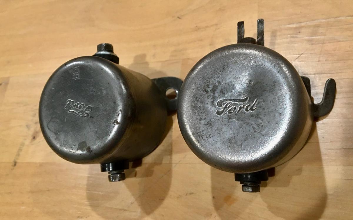

I have a '34 Ford which is unrestored and largely original. Glass date is 4-34. Is the cutout on the right in the photo correct for my vehicle? The car does not have a radio. Thank you.
12-23-2021 @ 4:21 AM
Posts: 1801
Ford script without a letter was used 32 till July 1934. Your generator should have two wire output one goes to the cutout terminal with the hex head screw. The L shaped bracket is for the earlier generator that has a terminal output and not the wire output. Yes the RH cutout in your photo with the L bracket removed.
