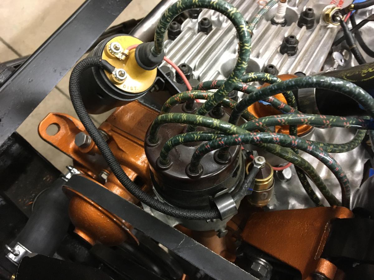

i need help. i had a newly built 49 flathead running and still in shop working on car so just running. i had a stud leak and thought i had to pull heads to i moved the distributor before i realized i could fix leak without pulling the lock down bolt on dist. So, i cant for the life of me find correct TDC or the best place to put #1 wire and really I'm asking what's the best way to install the dist. and get it running again. i do have a Mallory YZ distributor with mechanical advance. thanks for help. it would be a great present to me to get it running again.

Pull #1 spark plug and put your thumb over the hole as the dot on the crank pulley approaches the timing pin. If the compression blows your thumb off, you are on the right stroke. If not turn one revolution and align the pin to the dot.
Hold the distributor with the hold down bracket toward the head, point the rotor to 6 o'clock and install in timing cover. If the gears move it from 6 o clock, pull it back out and adjust so it will fall into place at 6 oclock.
Install the distributor cap and place the #1 plug in the hole at 6 o'clock. Follow the firing order clockwise to install the remaining wires. It should start. Use a timing light to set timing.

To find the spot to point the rotor, look at your distributor cap for the wire that goes to No. 1 cylinder.
The shop manual suggests that you scribe a mark on the distributor housing to show where the rotor was pointing when before you remove the distributor. My suggestion is the you get the engine lined up with cyl 1 at TDC, and then scribe the mark.

6 o'clock will work on '49-up. Actually, you can put #1 in any position as long as it is timed to the position and the firing order is followed.
