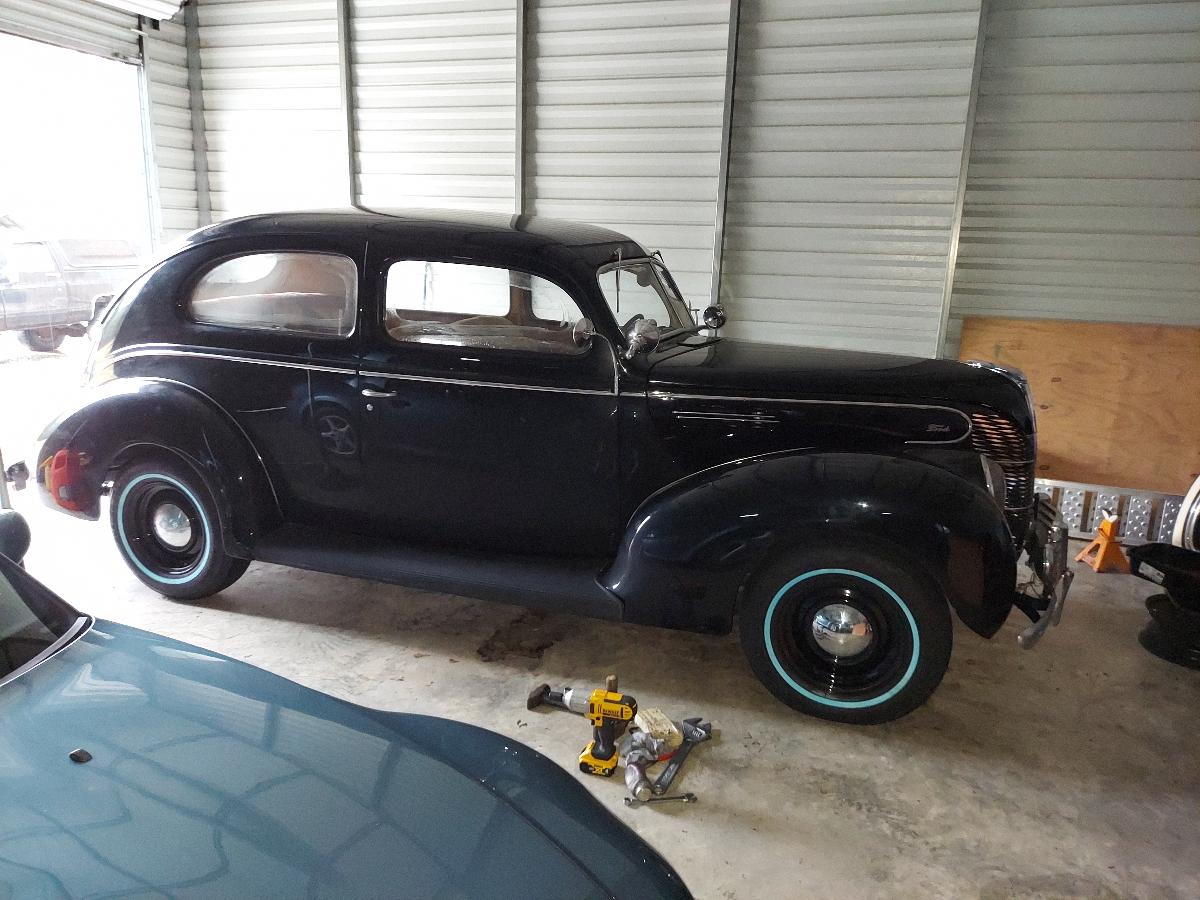

Converted my 39 tudor sedan to 40 model 5x5.5 hubs. Will 15x6 wheels with 3.75 backspacing fit under all 4 corners ? If so what is the best tire size to feel up the fenders with out any rubbing issues. Still has original axles and suspension front and rear.

The 15X6 wheel should work fine on the rear. I have used the 15X5 on the front, but I normally run a smaller tire on the front with a dropped axle.

Thanks for reply. Ended up with a set of 15x6 with 3.75 backspace smoothies and 215/75/15 tires. Basically because any other size was on backorder until atleast April.

The 215/75R15 tires you are buying are too small for your car.. According to the tire books, the average size of a 215/75 R15 is 27.1" where-as the original 600 x 16 is 28.3", an inch difference in tire size will make a huge difference in your gear ratio, under gearing it and there-bye raising the rpm's.
A 235/75R15 would have been a better selection, a 235 is 28.8, on the average, just slightly taller than a 600 x 16 at 28.3.
Tire and wheel fitment, and sizes, are probably one of the least understood items that tire salesman and the average motorists are aware off.
Reviewing the pix you posted I noted the tires you have on your car. I just put a similar narrow white side wall on my 53 Olds 88, 235/75R15 to replace 710-15's.
You should have your alignment corrected to allow for the radials, you should also put a hydraulic steering dampener on the tie rod to minimize steering issues.
I have used hydraulic steering dampeners, (looks like a shock absorber) on all of the solid I beam axle vehicles I have had for the past 30 years.

Thanks for the information. Was concernerd with getting too wide of a tire on rear and having rubbing issues. Ill give the 235 a look before I put this on the road.
