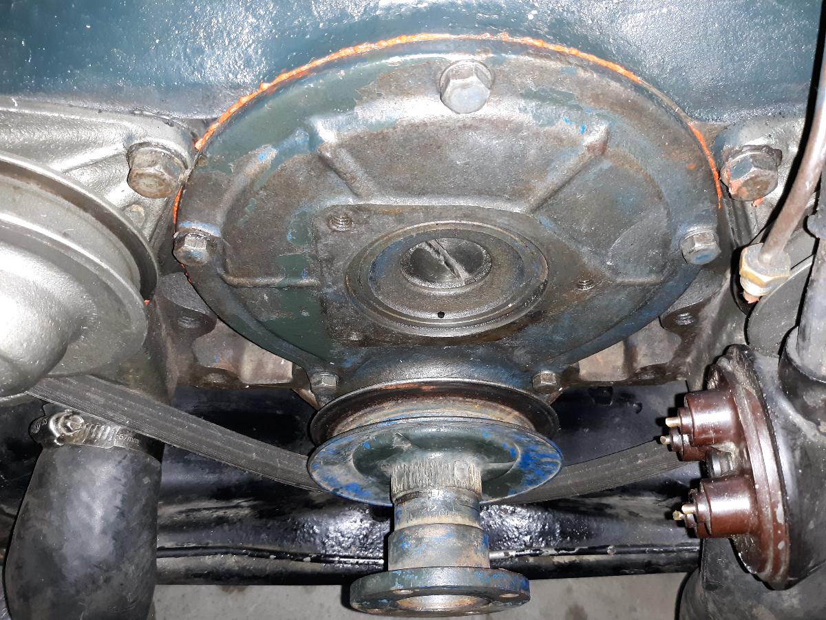

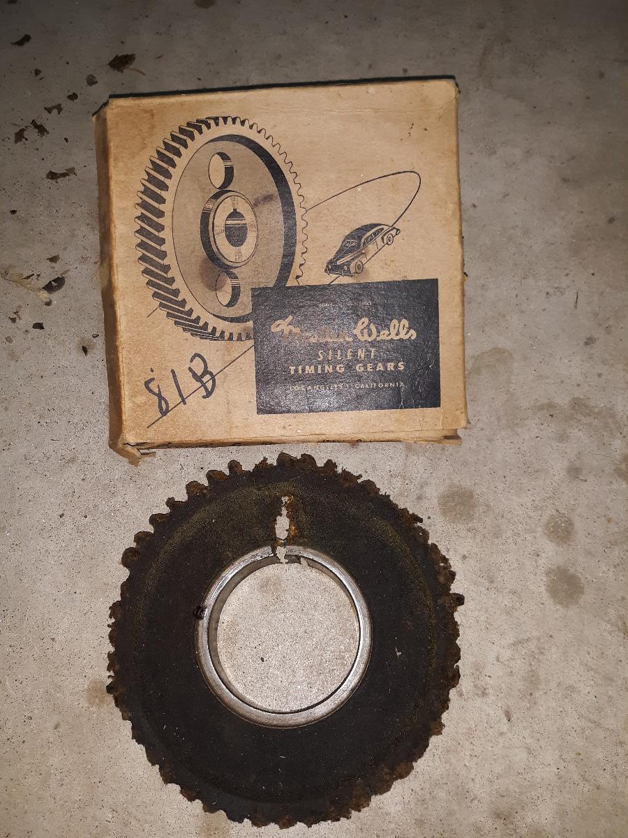

I just wanted to follow-up and let everyone know what happened with my old failed pressed-on Fiber Timing Gear issue. I mostly wanted to help the next guy out, if possible.
The description below from Richard Willim's book on how to replace a pressed on fiber Timing Gear while the engine is still in the car worked like a charm! The car now runs like a champ with a new timing gear in place WITHOUT having to remove the engine! Thanks so much for posting this easy and commonsense repair @carcrazy!
My engine still pulls strong and doesn't smoke much so this was an ideal candidate to attempt this fix on. Besides I didn't think I had too much to lose by trying it.

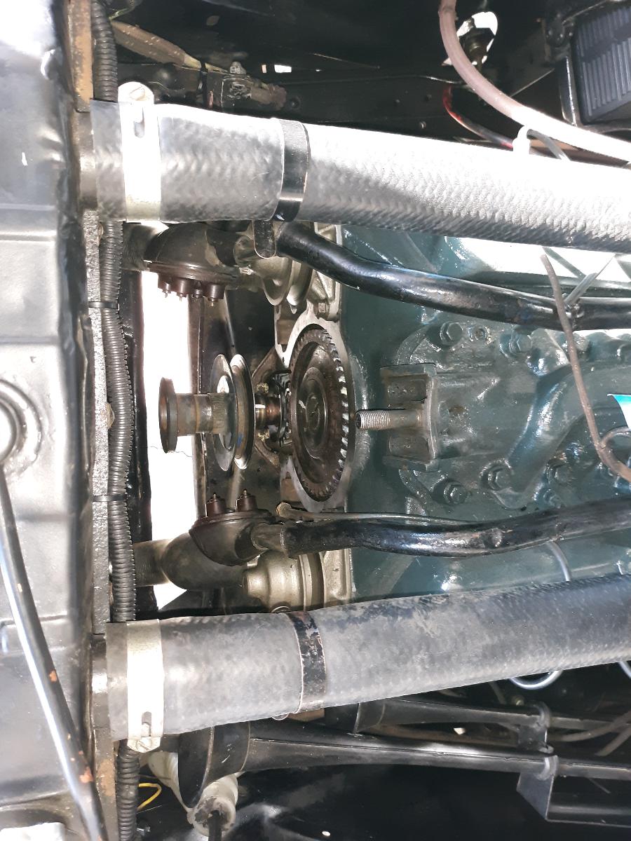

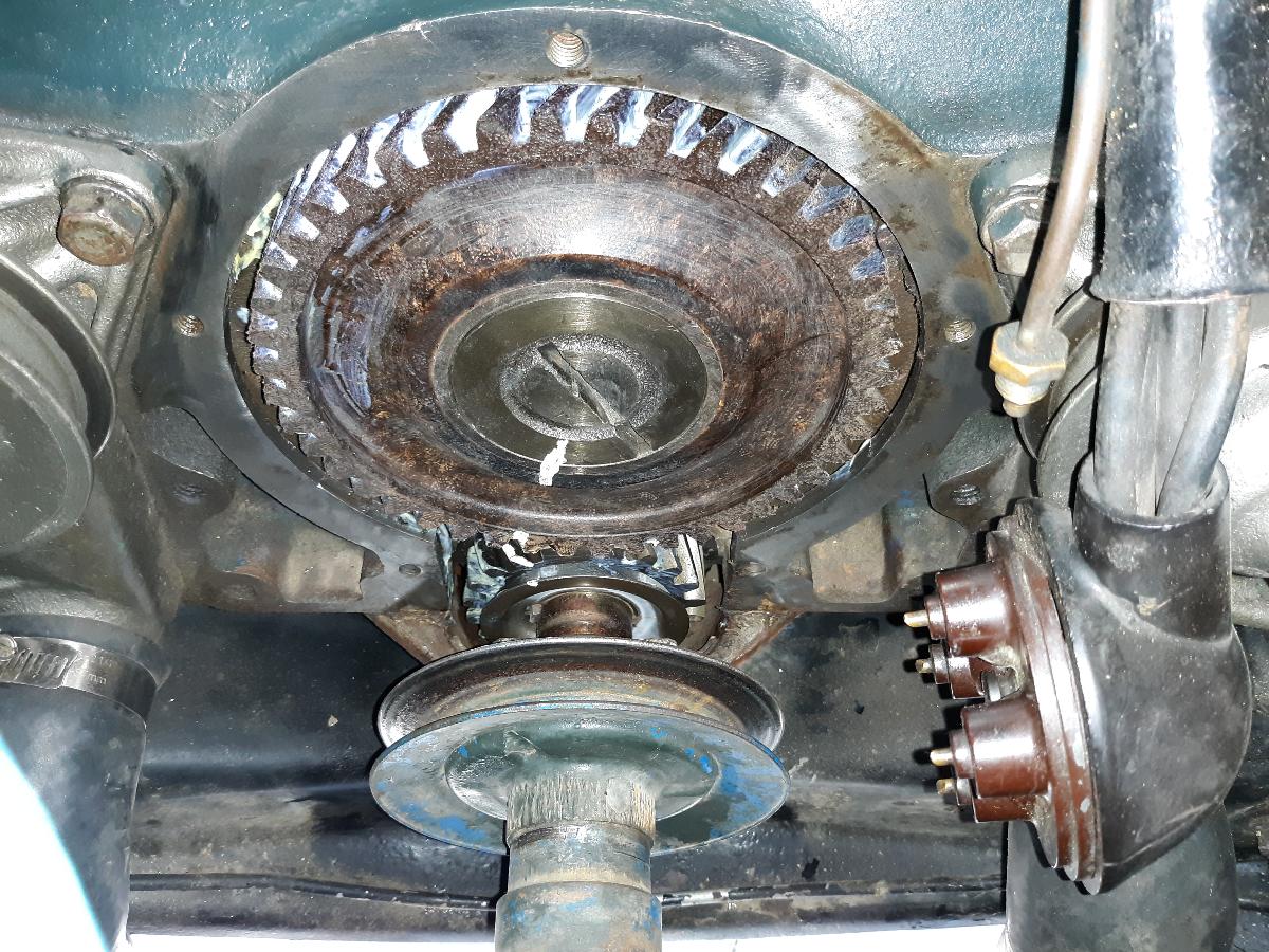

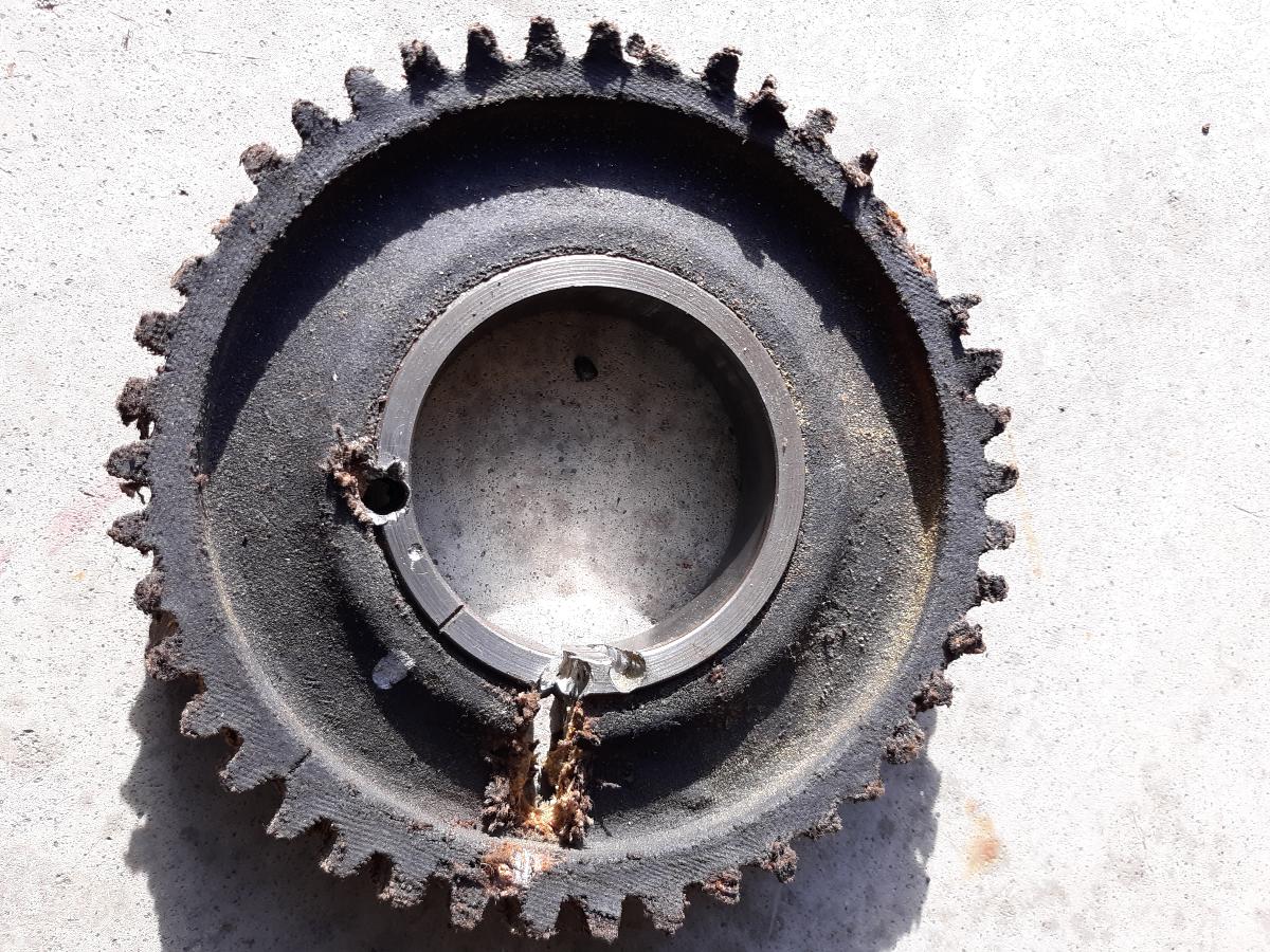

After taking off the fan-belt, fan, generator, the distributor, and the timing cover (I didn't remove the radiator or the grille) I wound up towing the whole vehicle to a nearby shop who did the timing gear work. Getting the old gear off was a bit of a fight as there is a hidden fin in the camshaft collar that rides up higher into the fiber of the gear and is hidden. But once the fin became known it wasn't too much of a struggle to get it off of the camshaft. Honestly, I could have done the job myself, except I was a bit worried about making sure the timing was exactly as I found it. A lot of care was taken to mark everything on the shaft and gear before tapping on the new gear. I then towed the car home and put it all back together. About the only thing I can add about this part is to make sure you purchase and soak the bottom timing cover grub in oil overnight (I soaked the grub in oil for a week) before sealing the bottom of the timing cover around the camshaft.
The engine started right up and runs better than before. I'm dancing a jig as I really didn't want to pull the engine. I cringe to think of the 1000's of 30's Ford V-8 engines that have been pulled and torn down unnecessarily just to replace this gear.
Thank-you to all who chimed in for your help on this one. And a very special Thanks to @carcrazy and Richard Willim!

To remove the gear, drill a 7/32" hole through the gears press fit steel ring. Gingerly drive a tapered punch into the hole. Be sure the punch is not too long. You do not want the punch hitting the block behind the camshaft gear. This procedure will spread the press fit ring enough to release its hold. The gear can then be slid off of the camshaft."
