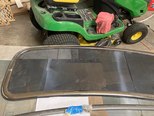

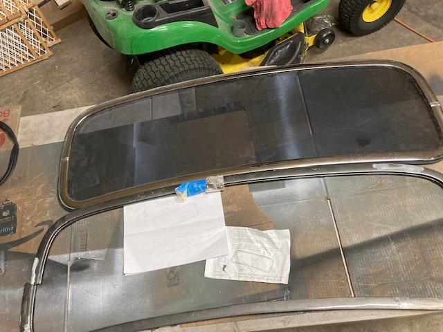

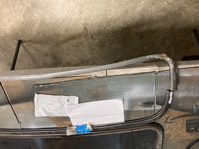

Finally had a chance to upload some pictures. First picture shows the two "frame assemblies". The top one is a chrome asembly and has a rubber seal and the windshield mounted into it. The bottom one is a painted steel frame (with substantial rust on the bottom). 1. Are these the "inner and outer" assemblies? 2. Does the chrome assembly go on the outside and the steel assembly go on the inside of the car, and the two assemblies are then attached to each other? 3. If so, how are they attached to the car? 4. How are they joined together? 5. Is there a seal or weatherstripping that goes on the inner assembly. Have also included a picture of the car before starting the rebuild, and yes, I know I should have done a better job of detailing the removal of the windshield. Sorry. Appreciate everyones time and advice.

Hello my name is Roy Lingard I just had my windshield replaced. THE frame is in two peace's ,there are 8 screws that hold it together 4 on each end, the rubber seal fits around the frame in a grove provided on the outside rem, there is only one seal. If you need more help E mail me at dragnil@sbcglobal.net
