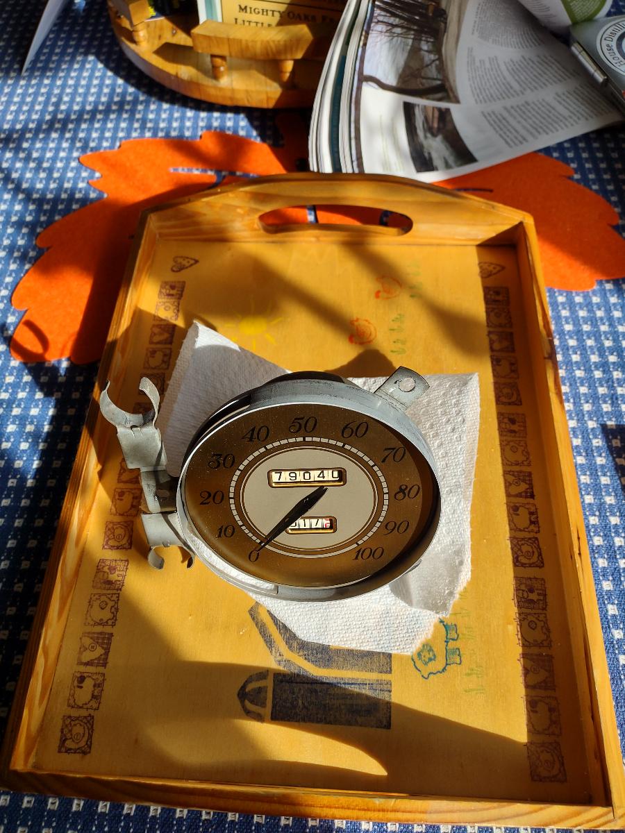

TomOand 37RAGTOPMAN, I removed the speedometer. Checkout the attached picture. I do not see any place to lubricate the speedometer. I have two questions; 1) which direction does the cable turn at the speedometer head? Clockwise or counterclockwise? 2) How hard should it be to turn with a square drive? Using a square drive and pliers it was extremely tight.

If the speedometer turns freely by hand, the problem may be in the sheath. Remove the transmission end of the sheath and insert a good part of your broken cable from that end to see if it binds. If you cannot find a good part to insert, get a universal cable from the auto parts store and use it.
Post a photo of the top of the speedometer and if there is an oiling wick, I will point it out to you. Some speedometers did not have the oiling wick.

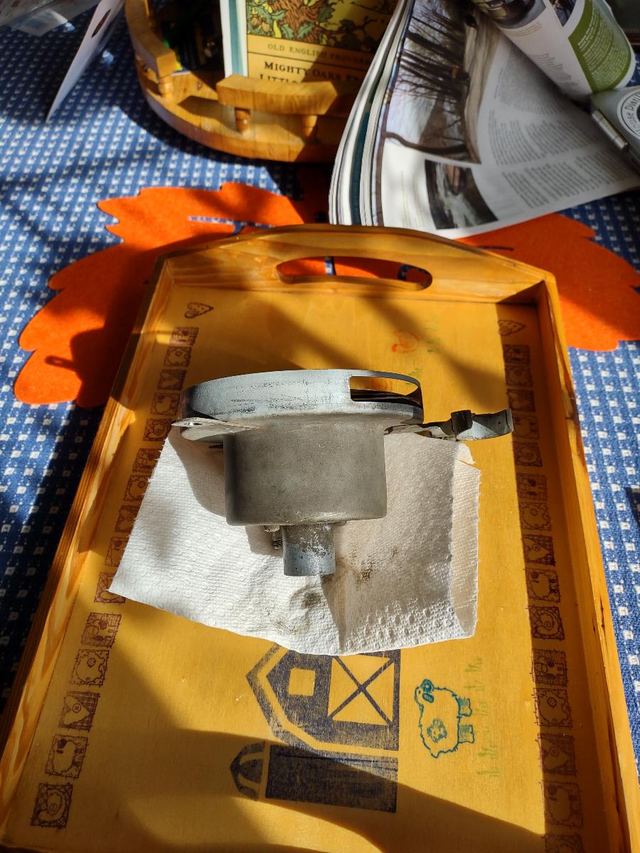

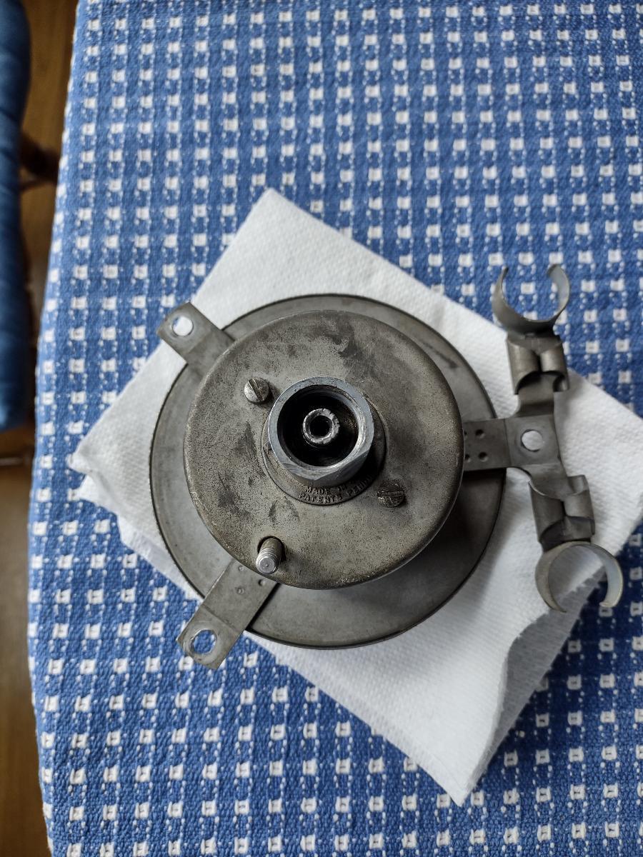

TomO,when I replaced the cable I also replaced the housing. I've attached pictures of the speedometer from the front and back. I could not locate any place for lubrication. A new cable and housing was ordered from Dennis Carpenter yesterday.

Ray, I agree with you, there does not seem to be an oil wick on your speedometer.
