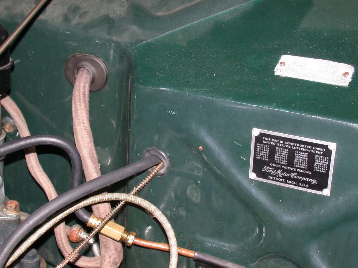

Thanks for the comment. Yeah, I dont think the hole is supposed to be there after looking at a couple of old photos of 1937 open cars. I have ordered Eastwood's "No-Weld Hole Repair Kit" to fill it and route the hoses and wires through that oblong hole in center of firewall. I am putting in a new dash harness, wiper vacuum hose and firewall pad so this is the time to make the fix.

I have experience with two 1937 Ford closed car dash panels, (aka firewalls), and have not seen the extra hole shown in your photo on either. I think it has been added.

I have finally got around to looking at my wiper motor now that my radio is out of the car. Inspection under the dash indicates the motor control rod was not connected to the dash switch...and the little rubber grommet was not to be found. So I removed the entire wiper assemblies and tested the motor by sucking on the vacuum barb connection and the motor seems to work fine as does the control rod mechanism. All the linkages and arm towers seem to work freely so I am in the process of ordering new tower gaskets, correct attachment hardware, wiper blades, vacuum hose, and intake manifold vacuum pipe/nut. The one question I have for 1937 model guys is: where should the vacuum hose go through the firewall? In literature I have, the vacuum hose shares the firewall hole with the dash harness and oil temp sender pipe...on my car I have a second hole where the vacuum hose and oil temp sender pipe pass through...see attached photo. Was this hole added by a previous owner?
