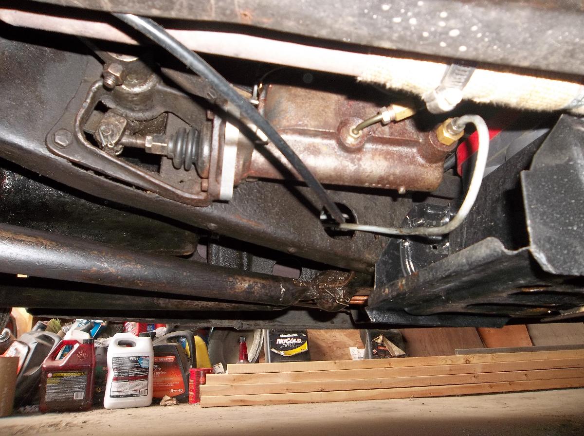

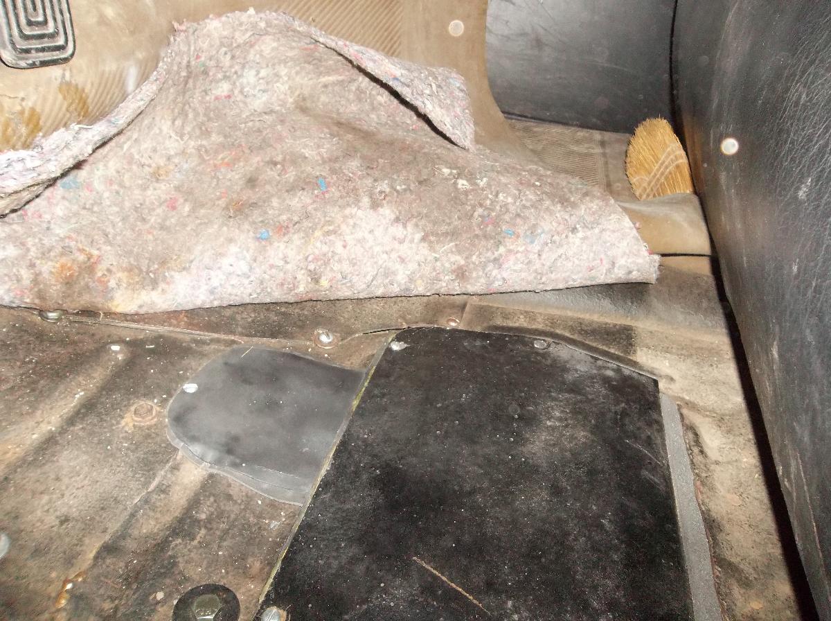

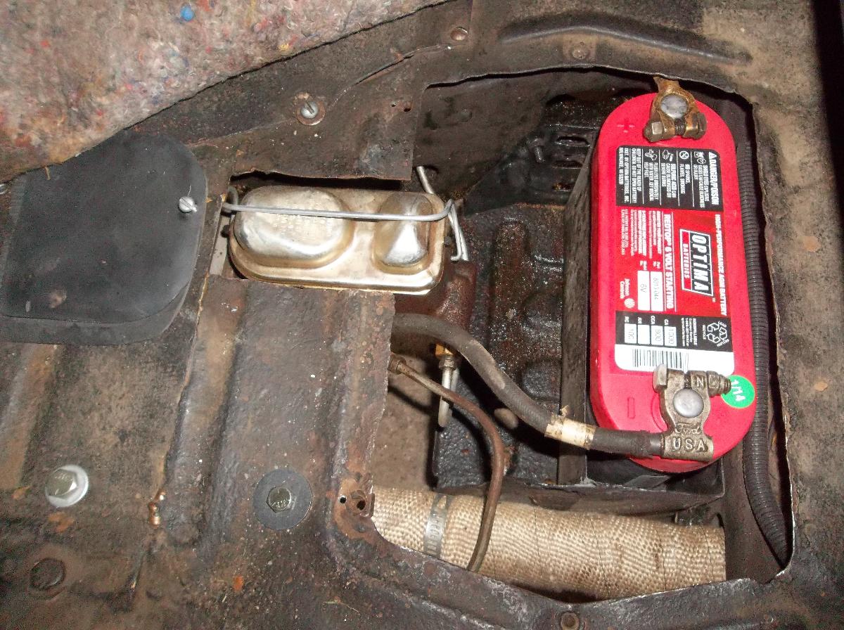

One option would be to use a 1949/1950/1951 Ford passenger car battery box. That's what we did to accommodate a six volt Optima battery when converting the 1939 hydraulic brakes on our '36 roadster to a more modern dual reservoir master cylinder.
The later battery box fit very well with a couple of minor modifications ...... two bolt holes and a vertical steel plate to hold in the Optima.
Hopefully you can enlarge these photos.
