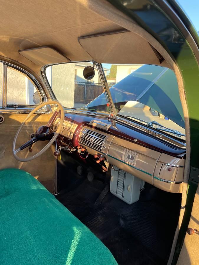

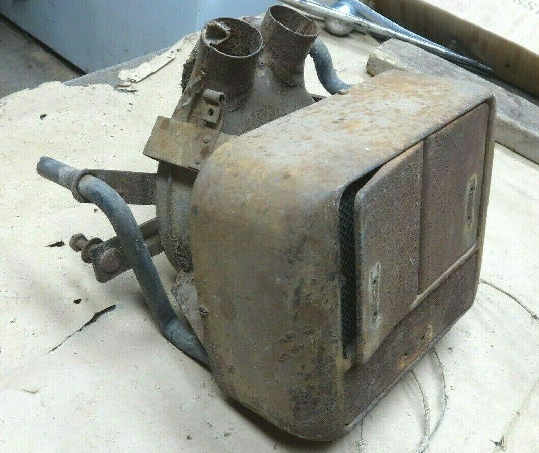

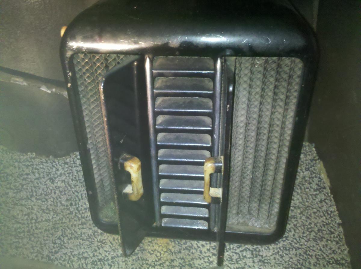

I'm assuming you mean something like this? they are on Ebay and in the classifieds of various forums on a regular basis. I've got one on the shelf right now I bought at a yard sale. Mount it under the dash, run the heater hoses, and wire up the blower and you'll be i business.
The second photo shows one installed in a '40
