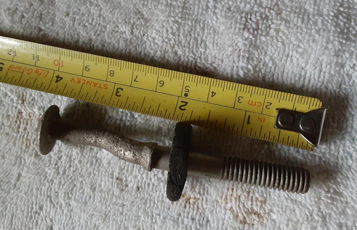

09-30-2021 @ 1:28 PM
Posts: 1095
I believe that this what you are looking for. This is for a 1937 Ford, but I think that it was carried over to 1938.
There is a black rubber washer
09-30-2021 @ 3:15 PM
Posts: 2881
Chris, you should know that the original hardware will need to be modified to accommodate the increased height of modern batteries. One, the hold-down bracket has a threaded stud that will misalign with the hole through the firewall, and two, the two hold-down dog leg bolts will need to be extended to be tall enough to engage the hold-down bracket.

Thanks for the pic and info on the new battery height.
Fabrication/modification is a part of the fun!
