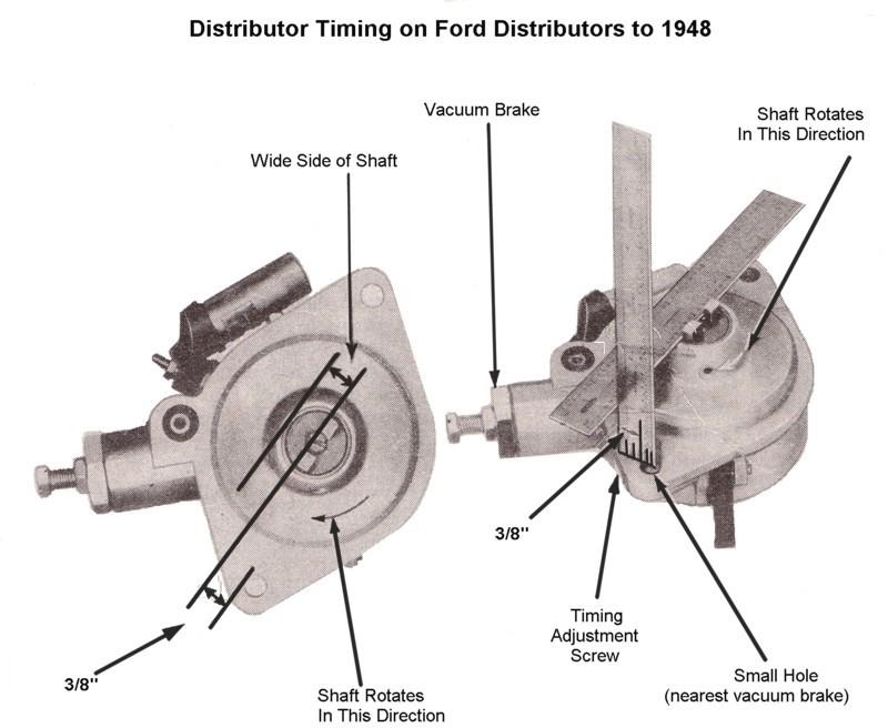

Now I have heard a few things about this ignition tune up . First most people can pull the distributor and install new points, condenser and rotor. I believe theoretically that if the points are gapped correctly the dwell will be correct or not? Second from what I hear there is a mechanical device Ford used to set the points/dwell and timing and that machine is hard to find if you can find one nowadays. Third if you set the points correctly and timing and put it back together the engine will run but not that good. Fourth I have seen printed in a few publications there is a way to set timing manually, use of two small rulers and by measurement set the timing. Fifth I have heard the replacement points that are made today are questionable and the petronix system should be installed.

Chris, The timing is determined by the opening of the left hand set of points. If you have the point gap set correctly, you will have the correct dwell. Both sets of points are set for 22.5 degrees dwell. The overlap of the make set with the break set should give you 34-36 degrees of dwell. If the cam lobes are worn your results may be different.
Setting the points with a feeler gauge requires the skill of knowing the correct amount of drag there should be on the gauge when you pull it though the points. If you use this method, you should use the 2 ruler method as a check on the timing of the left set of points opening. (the left set of points is determined by looking at the distributor as it is mounted in the car, not as looking at the distributor from the driver's seat). I would not use the screw on the side of the distributor to set the timing, I would adjust the points to get the proper dwell.

I am afraid I am confused. In one paragraph you said it's fine to the two rule method to set timing once the points are set. In another paragraph you said you would not use the screw on side of the distributer to set timing.
When I set timing according to the diagram I am using the 2 rule method uses 3/8 inch measurement from the screw hole. What am I missing?

I don't know what confused you. Here are the sentences as I wrote them"If you use this method, you should use the 2 ruler method as a check on the timing of the left set of points opening. (the left set of points is determined by looking at the distributor as it is mounted in the car, not as looking at the distributor from the driver's seat). I would not use the screw on the side of the distributor to set the timing, I would adjust the points to get the proper dwell. "
If you use the 2 ruler system to set the timing and it is off, you obviously did not set the correct gap on the points correctly, so instead of using the screw on the side of the distributor to set timing, it is better to adjust the point gap to get the correct dwell and timing. If the points are set correctly the timing will be correct when the side screw is set on the center mark.
I do NOT recommend the 2 ruler system, and I did not say that it was fine to use it, my only recommendation is to have the points set on a distributor machine by a competent operator. Some people like to do their own work and live with the consequences, so if you want to use the 2 ruler method, give yourself a break and adjust the points to get the proper dwell and timing.
