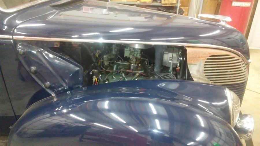

After reading the latest coil posts I had to post my latest story / question regarding last Saturday's experience. When I purchased my '38 in the summer of 2016 I made many trips where the car would kill and not start on a hot day. After consulting this forum I was informed I need to purchase a Skip Haney rebuilt coil. I purchased a coil from Skip and have been cruising around ever since. During the summer months I remove the hood side panels to allow for additional air circulation and looks. The temperature was in the mid to high 90s and the heat index was over 100. The engine temperature gauge was running around 160. After a 15 mile non stop trip I encountered two consecutive stop lights. The car stalled and would not restart. I pushed the car off to the side of the road and waited for the car to cool down. The '38 restarted after a 30 minute wait. It was a nervous 30 minute drive home, but I made it. So what happened? Did the coil and or condenser breakdown? As of the post the '38 will stay in the garage until milder days arrive.

You talk about removing your hood sides to help keep your car cool. I have a friend with a '37 Ford street rod and the car ran very well. He removed the hood sides just for kicks one day. After he removed the hood sides the car ran very hot. He replaced the sides and the car ran great. He is thinking that the air was hitting the cowl and firewall, creating a positive pressure in his engine compartment and not allowing enough air to go thru his radiator. Sounds plausible.
40cpe
09-12-2021 @ 7:05 PM
Posts: 488
I don't see how open sides could create pressure in the engine compt. I have a '38 with the sides removed. I bought damaged hood sides and repaired them to use just the grill section to avoid the snaggled tooth look. I live in the deep south and the car doesn't run hot. I think your friend needs to look elsewhere, maybe a sticking thermostat that coincided with the side removal.

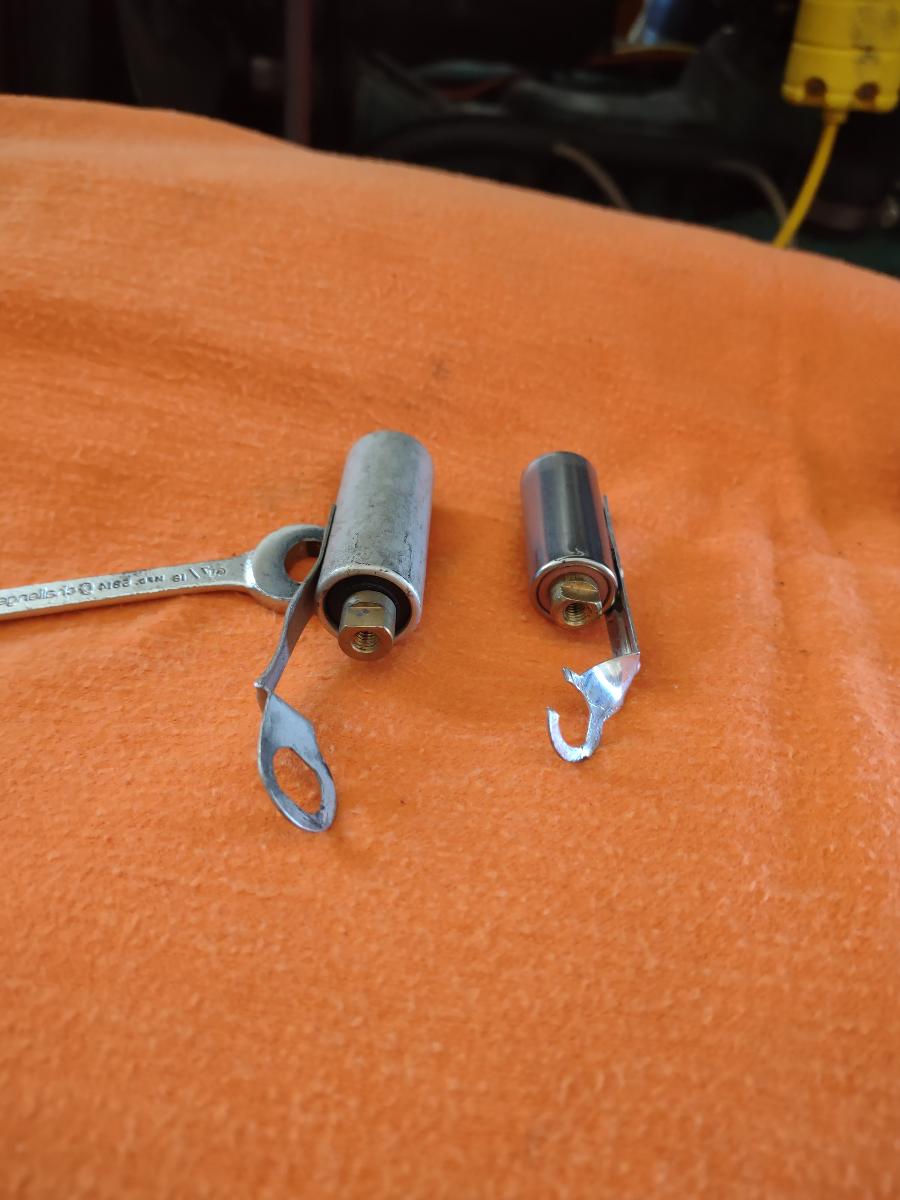

Tom, I ordered and received condenser ECH FA49 from Napa. I finally had time to installed it today. Why is it a simple task becomes extremely difficult? After connecting thenew condenser to the coil I could not get the coil to seat. Nothing seemed to work. I removed the coil and condenser and compared it the one I removed. The grounding flang is 180deg off from the removed condenser. See the attached pic. I attached the original condenser and the coil seated easily. Also note the size difference between the new and original. Any help would be appreciated.
Thanks
Ray
