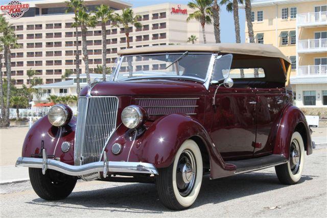

NICE 36 PHAETON ,,,, PHOTO looks like it was taken in FL ?

Thank you; previous owner purchased the car in California from “Checkered Flag” motors - no Palm Trees here on Mount Desert !
