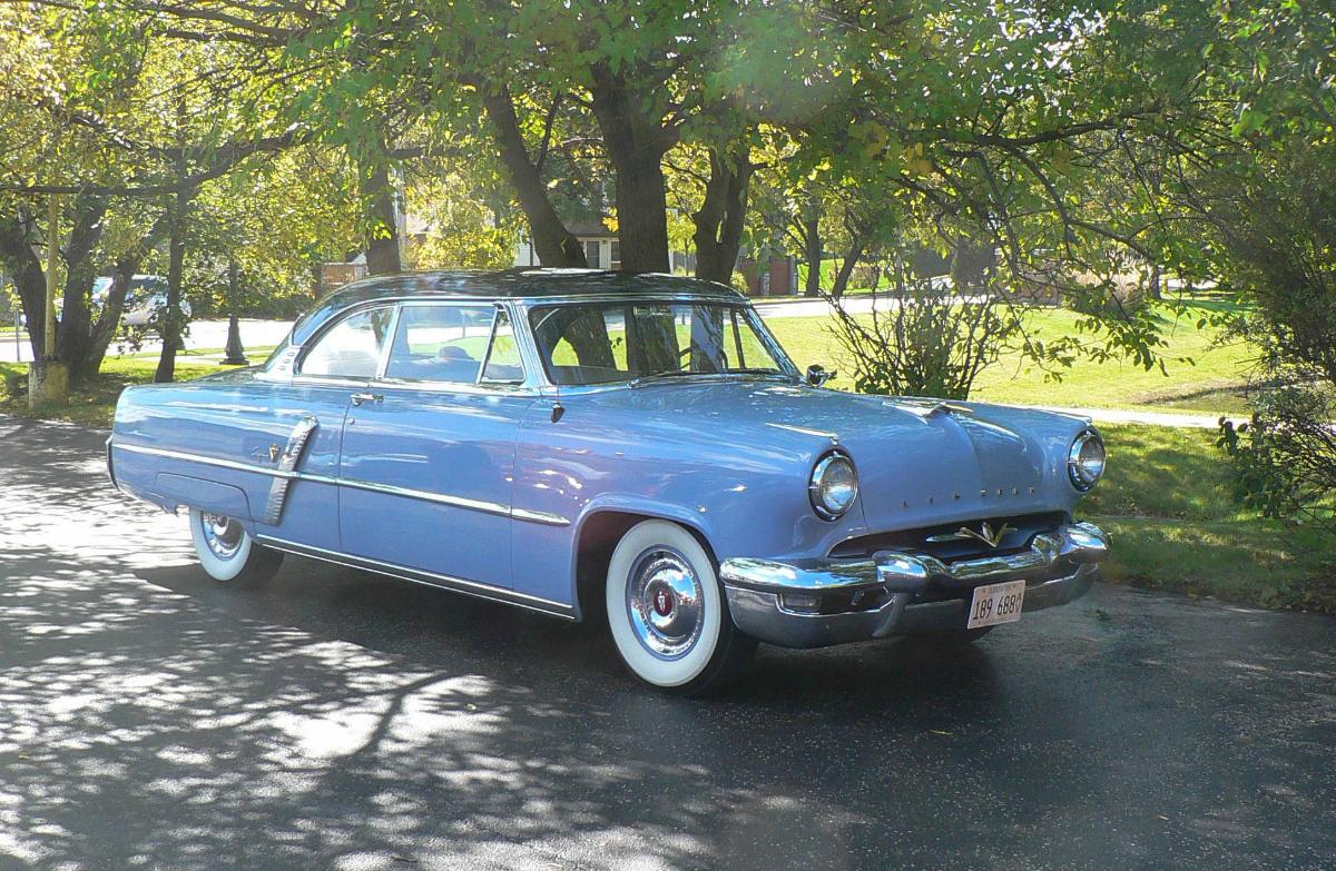

Use a random orbit polisher to apply a cleaner, cleaner wax or polish. Use the foam pads with the polisher.
If the paint is dull with out water spots a cleaner wax like Girot's will give it a nice shine. If you rub over the hood with the back of your hand and feel any roughness, definitely clay the paint before you use a cleaner on the paint.
If the paint is dull with many small scratches or swirls showing, clean the paint with Meguiars fine cut cleaner, then apply Meguiras show car glaze and working it in to the paint with a polisher and let it sit overnight. Wipe it off and if the paint does not shine, repeat the application of the glaze and let it soak into the paint again. Follow up the glaze with Meguiras Yellow wax. After a few months, you can try any other wax that you like, but I like to stay with Meguiras products on my Lincoln with the original paint. I used this process on my Lincoln and now you can see that the Crown Blue Metallic has some metallic in it. People have a hard time believing that the paint is original.
