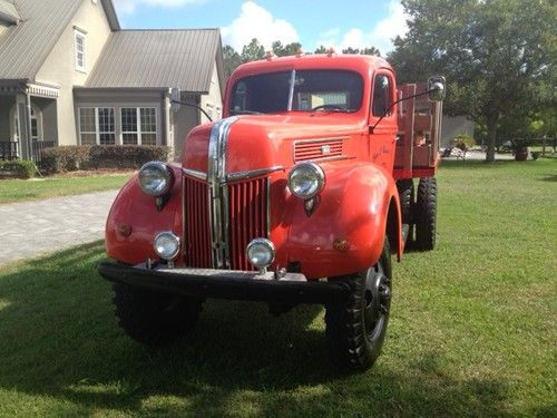

The Guy that sold this truck says it is a 1939 1 1/2 ton Dumptruck . I don't think he's correct because all photo's I've seen and characteristics, grill, hood,. etc. are leaning toward the 1941 Model. Am going to get Bill of Sale but do not want the wrong year model listed on it. Do not have a title but have located the Serial #'s on the frame and on top of the transmission. They match up and would like to get a bond title or something to get licensed.
The Serial Number should tell me what model for sure shouldnt it? Are there a serial number list that tells year model and when made?
New at these older vehicles...lol I can list the serial # if anyone can tell me the year. Any help would be appreciated
The photo below is just for reference but it's the the same style ...it lists it as a 1941 model. The 39 grill is different therefore I think he is wrong about the Model.

I can see nothing in Vanpelt that talks about 99T engines. The 95 horsepower Mercury engines were stamped 99. So my best guess is you have a 1941 95 horsepower engine that is in the sequence with the Mercury engines but has certain features that make it a truck engine. Your pictures indicates it is a 41 truck as well.

post a picture--99T is the 95 hp engine and T is for a truck. I have or have had several of these trucks. cabs from 1940 to 47 are about the same. 39 cabs have windshield wipers on the roof, windshield would open up
