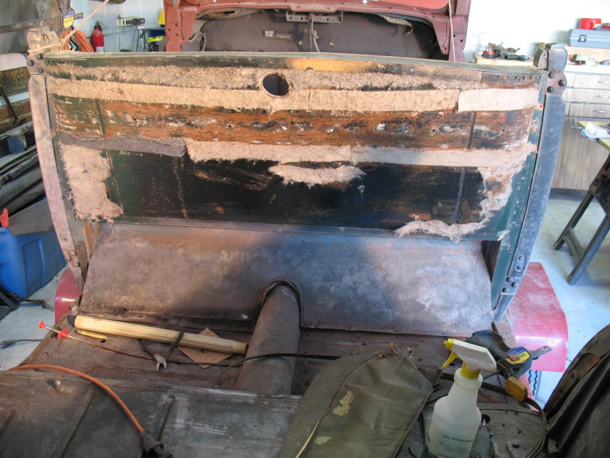

Does anyone have pictures of a car under restoration that shows the inside view of the cast center pillar assembly?

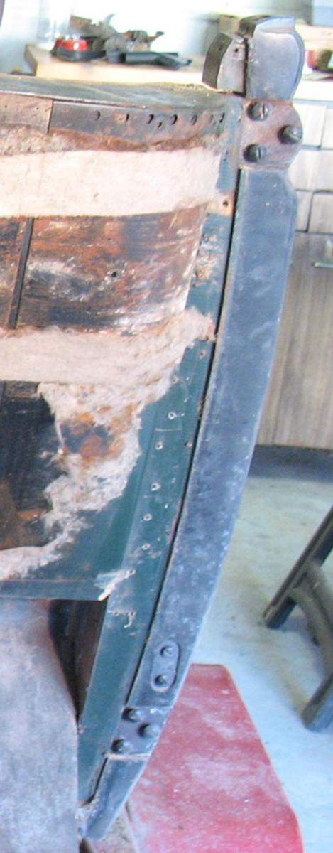

If this what you mean by the cast center pillar?

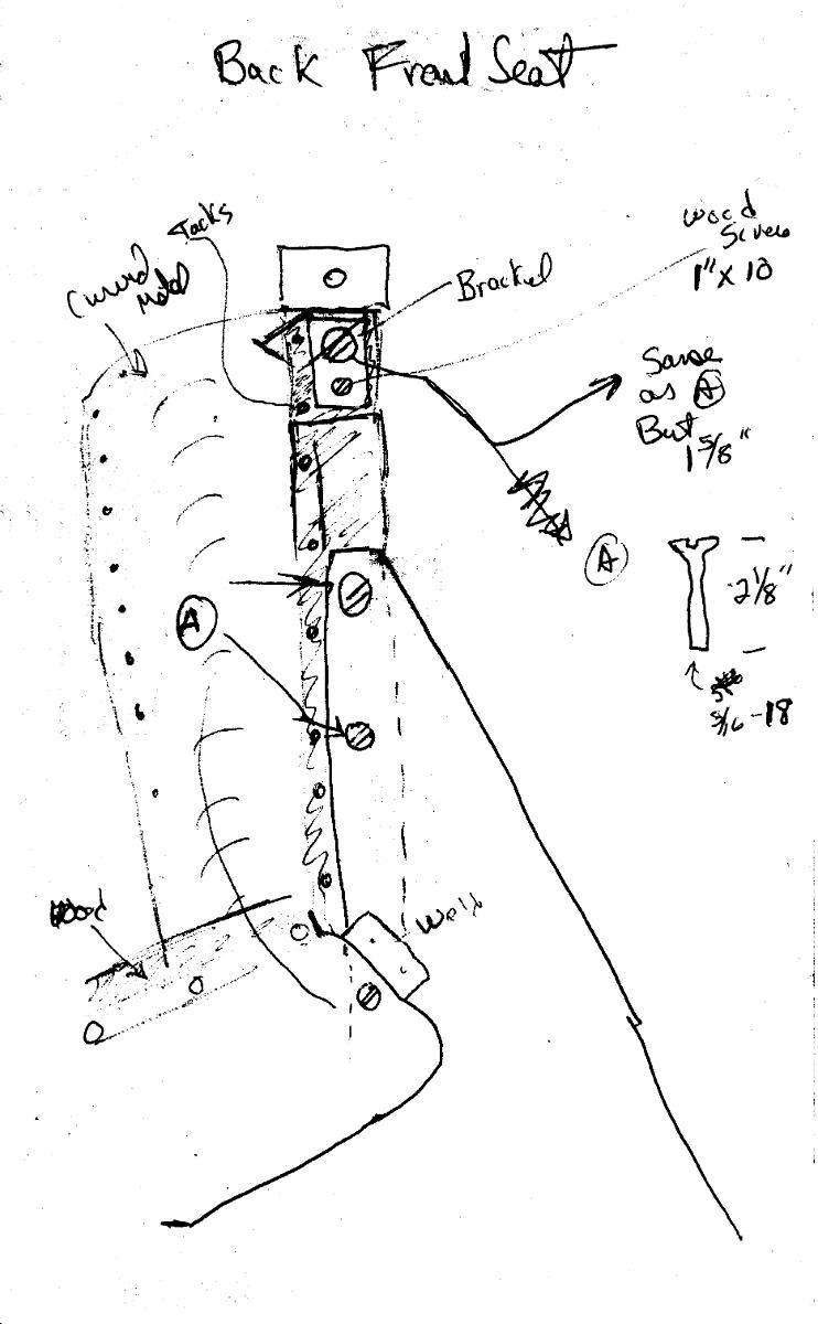

Yes thanks . We are fitting the metal seat cover to the posts and are missing the t bracket and the lower floor riser.
