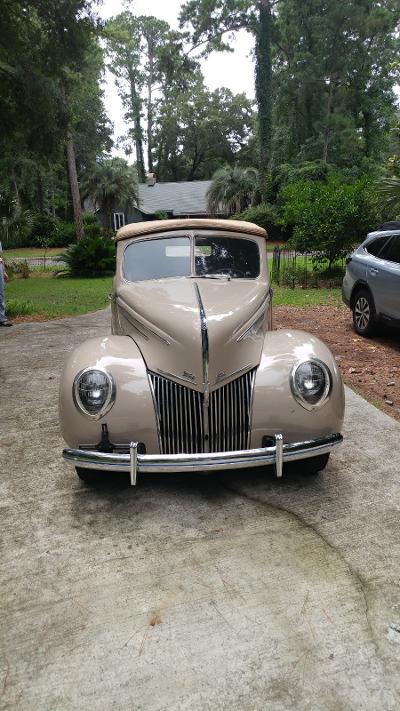

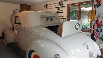

I am new to the forum. I am now the proud owner of a 1939 Ford Deluxe Vert with Rumble Seat. It runs but doesn't stop well so I am replacing all of the brake system from the master cylinder to the wheel cylinders. Parts are on the way. If that doesn't fix it, I will look then at the shoes and drums.
But my question is about the electrical system on my Pride and Joy. I used a volt meter to see what voltage the battery reads and it says 12 Volts. So I assume that all operating systems that use electrical current are 12 volt: ie the starter, alternator, lights, windshield wiper, etc. Hope I am correct in that assumption. I was told that the flat head engine in my car is not the original but a 1946 or 1947 engine. Could that account for the change to a 12 volt system? I was under the assumption that the original 1939 Ford was a six volt system.
I guess you could say I was mildly shocked (pun intended) when I saw the positive terminal lead bolted to the fire wall! My first experience with Henry's take on electrical matters.
******I learned from the original long term owner of this vehicle that he did change from 6 volt to 12 volt. Now we move on to the braking system. Thanks for everyone's help and advice. I have learned some important information in my first week of being an Early V8 owner. *******
