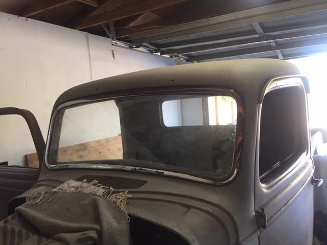

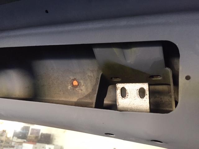

Foldout windshield on my pickup. What piece is missing allowing attachment to overhead anchoring points.And, where would I find such a thing?
Until today I assumed the tabs on the frame would mate up directly without realizing it would need some sort of hinge.
Thanks all!

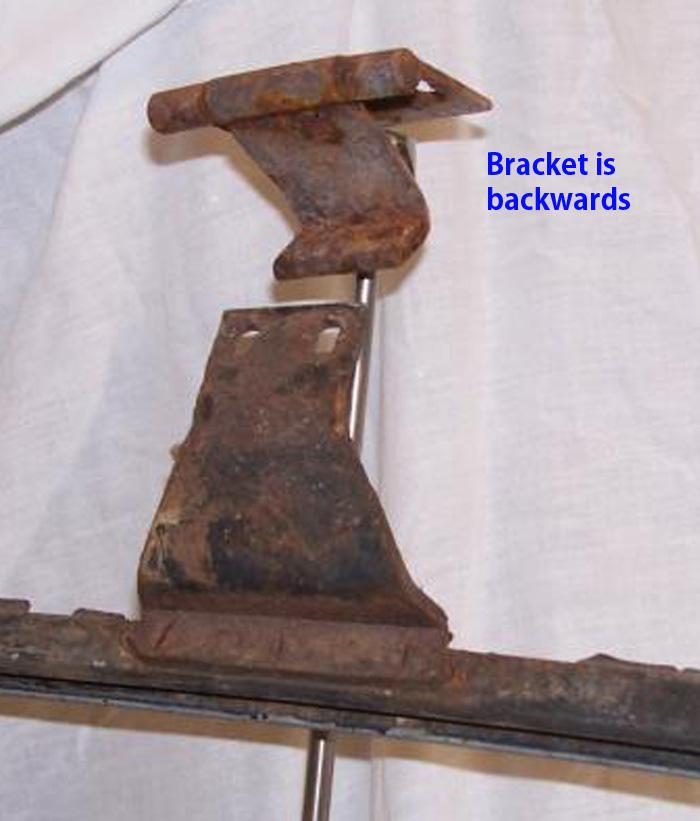

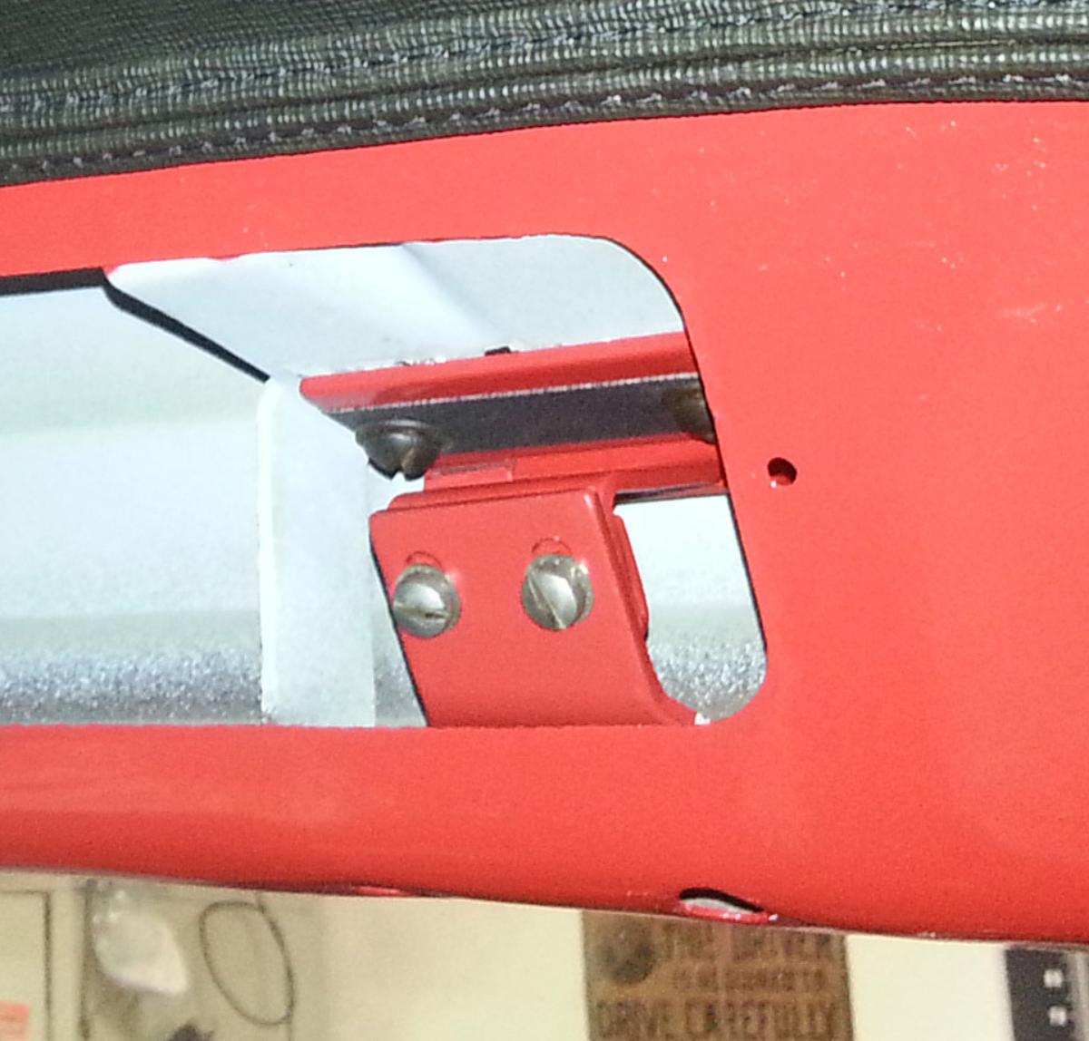

You are missing the hinge brackets. One photos shows correct installation and other photos shows hinge bracket, but it is orientated bckwards in the photo. Hope this helps.
