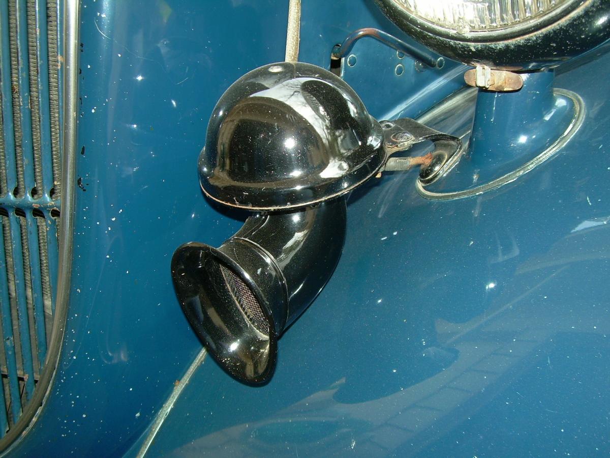

I’ve put new fiberglass front fenders on my ‘36 pickup and I’m attaching a horn. Am I correct that the horn mounting bracket is attached by the bolt for the headlight stand? Also, how does the wire for the horn pass through the fender? Thanks
This message was edited by CDemarest on 6-10-21 @ 2:45 AM
06-10-2021 @ 5:39 AM
Posts: 1095
Yes, a special carriage type bolt with a hole in the center is used to hold the horn on.
See attached picture.

Thanks! I’ve ordered the bolt with a hole.

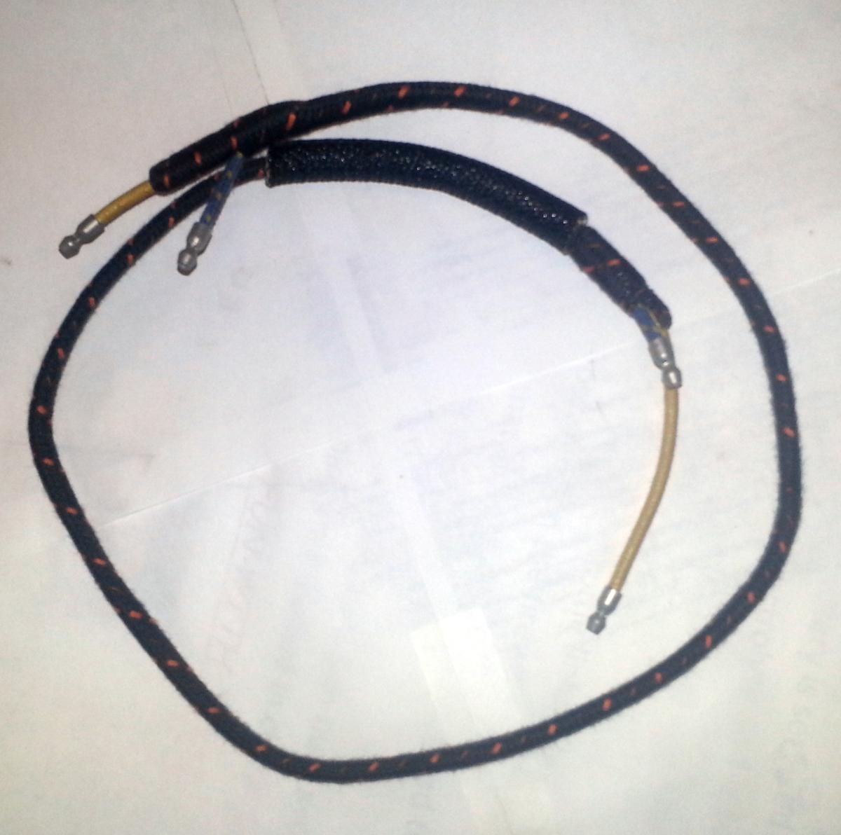

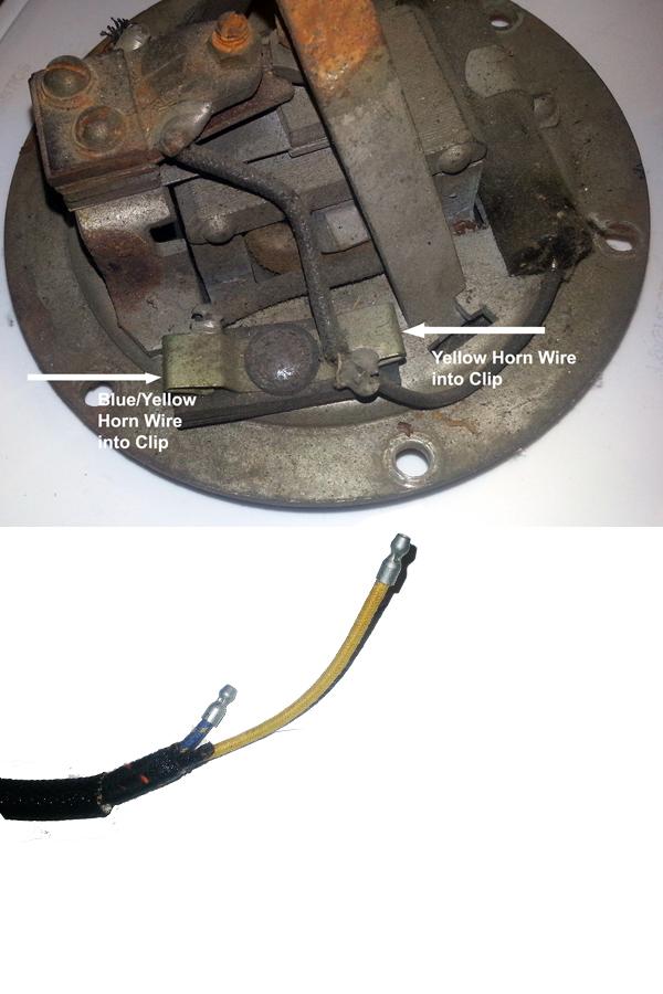

Be sure to provide a ground wire to complete the electrical circuit to your horn.
Don Rogers
06-10-2021 @ 5:15 PM
Posts: 512
The correct horn wire for a 36 pickup horn has both the + and - wires and doesn't need a ground wire. The horn electrical components are electrically isolated from the horn case and mounting bracket.
